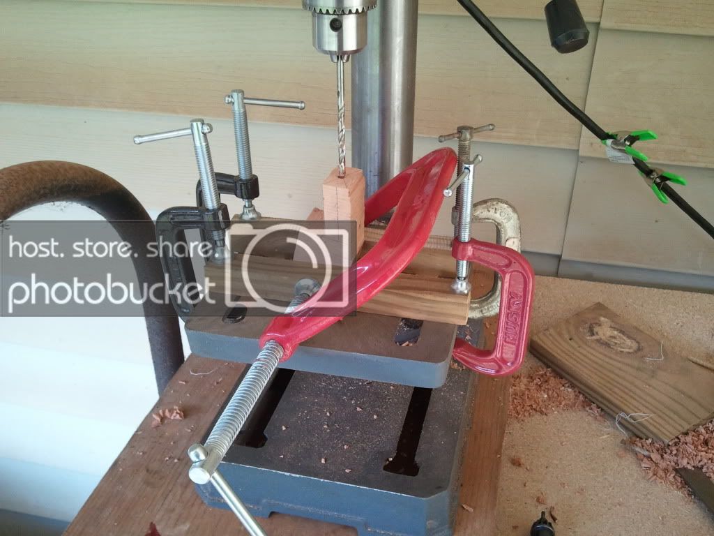

/home/dgerwin/Pictures/Drill Press Vise.jpg/home/dgerwin/Pictures/Drill Press Vise.jpg
I had to do this to get pipes drilled. It also works for pen blanks. since it only has 2" quill travel, I had to drill 2", extend the bit from the chuck and finish drilling the blank. Much easier to drill on lathe.
