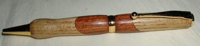

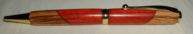

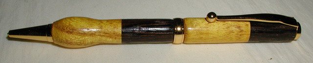

I made 3 of the comfort pens today and I leave the gripper off altogether because I like the fatter style.

Bev;
Those are awsome. I dont think I will use the gripper anymore either and I agree with the fact that they look nice fatter and without it.
What is the little black strip betweem the laminations on the top two pens? Ebony , or a plastic material or something else. Sure looks nice.
W.Y.
Didn't think anyone would notice. I use a fine permanent ink pen and just outline the insert. This also hides any imperfection in the way they match although I haven't had any trouble matching them so far. Just a little trick I thought of.
