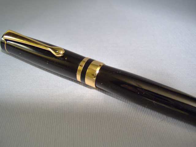

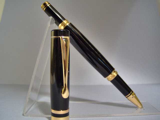

I have some ebony that I can send you. A while back Rockler was selling a bunch of ebony for $1 each and I got quite a few, so I have more than I need right now. I will go through what I have to get one that is black black. I made a pen for my son last month using this and you have to look real closely under good light to get any hint of any grain in it. It is absolutely black. I also have not had any problems with it splitting. If you are interested, pm me your mailing address and I'll get a couple out to you next week no charge.
Hi,i just finished a black acrylic from fellow3 group buy and the black in that is just perfect,, Carl
