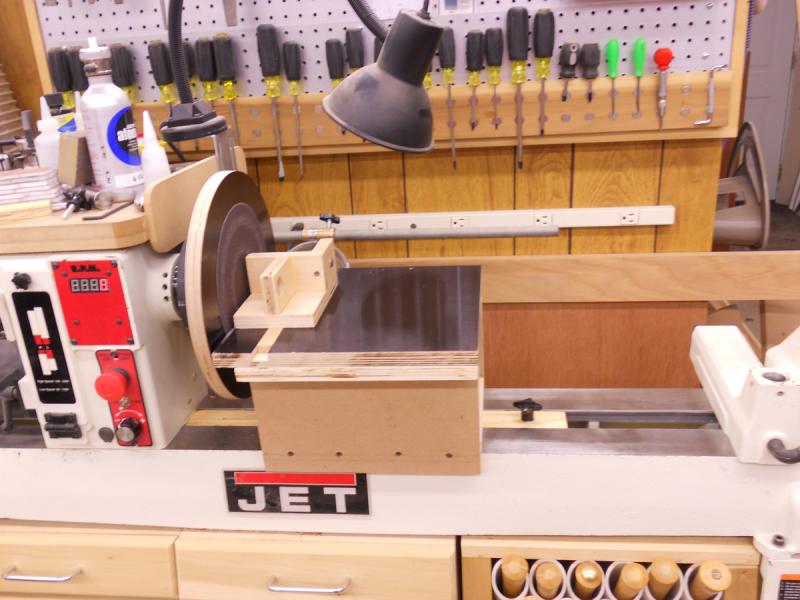

I too have been looking for a new disk/belt sander because my Porter Cable was so lousy on dust collection. I looked at review on sanders from Wood Magazine and decided that the price for a new unit was more than I was willing to spend.
Since I have good dust collection on my lathe I did some further research and came up with this unit (12 inch) that should be large enough to eliminate the need for a belt sander.
DUH!!!!!!! Why didn't I think of that:biggrin: That is a great Idea until I can afford a GOOD dedicated sander unit.
