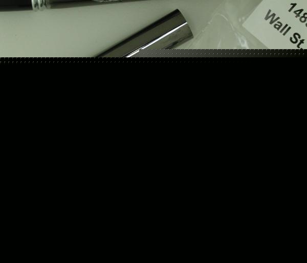

If you need black, chrome or white check these out. I have been using them for a while with great results
http://woodcraft.com/family.aspx?familyid=20993
Available for several pen styles.
Chuckie
PS
Here is a photo of the BL NI tubes for Wall Street II:
