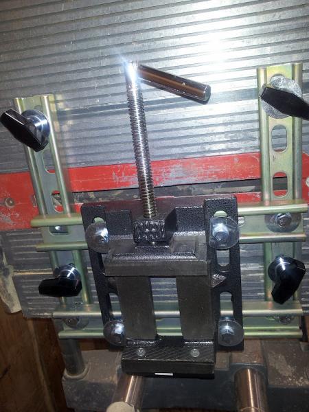

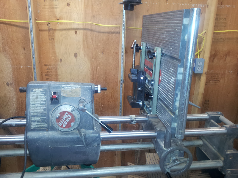

......on my ShopSmith and this is what I came up with.

I had to do some grinding on the 5/16" Fenders to make a t-bolt big enough and I will eventually get the right stuff but it holds and is rigid enough to drill horizontally so I don't have so much set up. Now to build a DC box that slides under and up the back to keep the area cleaner.
Next up, a rotary table mounted the same way.
