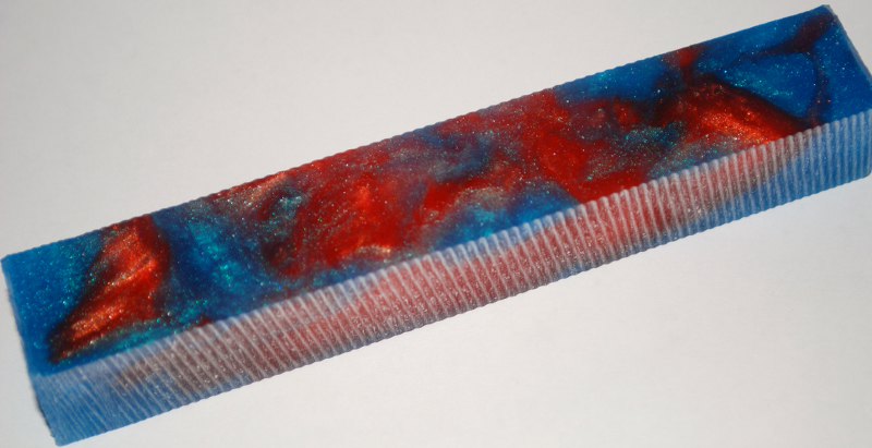

My last pour I think I used about 10 oz of pr to the small nail polish bottle. (couldnt find my notes from prior pours) I got them on sale for .99 cents each so I wasnt really out of anything. I havent turned this one yet but know I will have to paint the tubes as well. I'll probably cut back to about 8 oz of pr per small bottle (.40 fl oz) of nail polish next time for stronger color with this blue. Its a little light.
Wow, that looks really good! I may have to try that. Right now I've only tried some of the PearlEx pigments from the craft store... and they ain't cheap! I know I can get cheaper stuff in bulk online, but for now I'm still trying things and experimenting. Thanks for the info.
