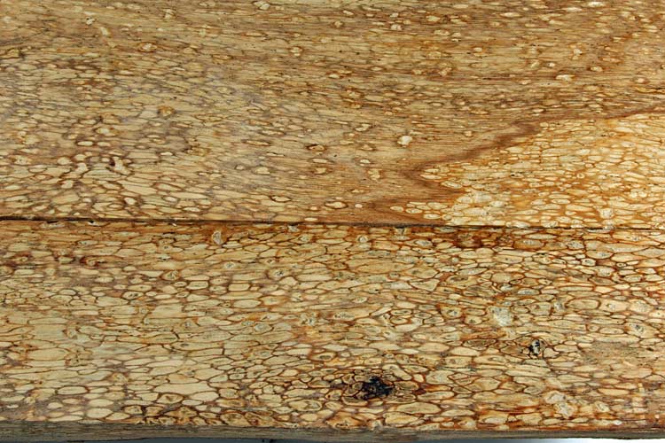

These boards came out of a log found in the woods. I don't recognize the wood and I've never seen figure like it before. It doesn't have a 3-D look, so I wouldn't call it pomelle, or blistered, or quilted. It doesn't match what I've seen called beeswing. It looks more like a honeycomb (almost cellular). The figure appears in both the heartwood and the sapwood, although it is more pronounced in the sapwood. What would you call this type of figure? Any opinons? If anyone can identify the wood, I'd appreciate that too.
The figure shows up in the endgrain as well, so I expect that it will appear all the way around a pen. I'm anxious to turn a piece and find out.

I am telling you,it's very unusual. Beatifull at that. I try to find the site for you and email you. Not too long ago I was palying on the computer and googling for wood and there is site that all the wood spicies on it and you could look it up then it has email address that you could send a pic. or a sample that they will tryto figure out what it is for you.. One of the universities.
Have only seen spalt like that in maple , but that doesn`t mean anything . Thin CA the end of a couple blanks , sand to 320 and post a picture , and I might be able to help . A piece with growth rings about 1/4 inch wide would be most useful .
From the weight, look, and smell of a not-yet-rotten piece from the end of the log, as well as the other trees in the area, I'm beginning to suspect that this might be smoothbark hickory. The figure appears to come from the pattern in which the wood is decaying. The pale cells are much softer than the brown separating lines (and will need stabilizing). Looking at sounder sections, the pale spots are present, but much smaller.
Of course, I haven't ruled out beech or sycamore yet. I have both growing on my property as well (although generally more downhill near the river). I hope that makes things more interesting.

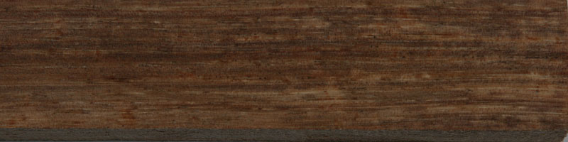

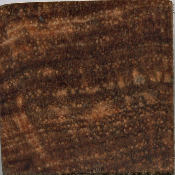

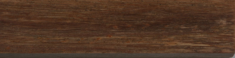

Here are a few pics of a pen blank from the sound end of the log. The blank is about 1 inch square. I tried to keep the color rendition as true as possible, but colors appear different on different monitors. I'd characterize it as "pecan brown". That is, a medium-dark brown with slight red tints.
Does that make identification any easier?
Regards,
Eric
P.S. The pores in the endgrain are bigger than I think beech or sycamore should be, and the rays are invisible except under magnification, so I'm leaning more towards hickory. There is also a photo of hickory endgrain on hobbithouseinc.com that looks very similar. Did I mention that the sound wood is very heavy?

I would think it is one of the true hickories ( Pignut , Shellbark , Shagbark or Mockernut) . Pignut is supposed to be the densest of the hickories , but I would expect you could find samples of Shagbark and Mockernut that would fall into Pignuts density range , depending on growing conditions and position in the tree .
I've decided that this must be Pignut Hickory. It grew in an area that has different hickory types (including shagbark, shellbark, and pignut). The trunk in question grew up right next to 2 pignuts, and there was a small piece of bark left that was definitely not shaggy. I have some other hickory species as well (either mockernut or bitternut), but they are less common and growing in other spots. There are no sycamore or beech trees in that area but lots of hickory, white oak, and red maple.
I also believe that the pattern in the wood is not true figure, but the result of decay. It isn't really spalt, but rather small spots of rot spreading into one another. Different areas of the log show different degrees of decay - from solid wood, through slightly spotty, to honeycomb-like, and downright punky. It is all still damp and will need to dry before turning. I'll make some blanks available for others to try soon.
