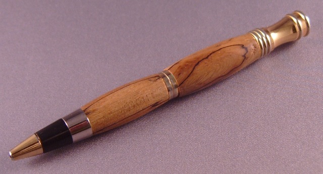

Then this might be a first for you, George. My youngest sone turned this spalted Pecan pen for me when he was 12. He is 25 now and I carry, and have carried this pen nearly everyday since he gave it to me. While the shine has long since worn off, I certainly don't see any grime. I know the barrels are a little proud, I knicked it somehow up by the finial, and the plating has worn off where I hold it. But the Pecan still looks amazing... IMNSHO.
