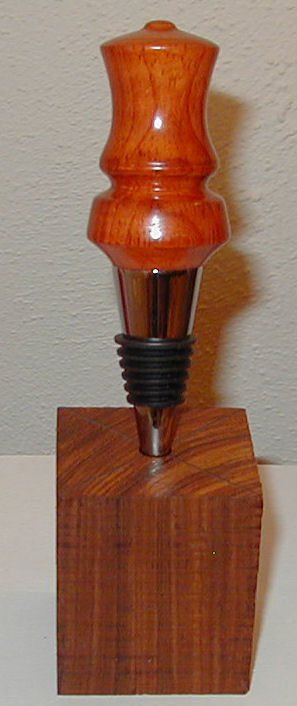

Those are all great looking works of art everyone...I thought I would give it a try...hope you don't mind if I post a pic in this thread of my first attempt at a stopper, it is no where near as good as the one's already here, but hey, it was my first...and it was so-o-o-o much fun [:)]
JohnPayton
<b>Image Insert:</b><br />
<br /> 69.52&nbsp;KB
I hate to admit it, but I don't really know. I ordered a kit from PennState about a year ago that included the lathe chuck, drill bit, stoppers, and assorted woods - basically everything needed to get started. But never really had interest in trying it - was to busy having fun making pens/pencils. Some of the wood looks like it has very intersting grains, hope I can do it justice, because unfortunately my photo skills won't.

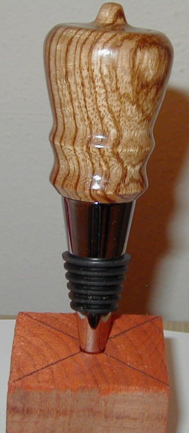

Thanks for the wood ID YoYoSpin, can you help with this one too, please. I have a few more pieces of unidentified blanks that will soon be bottle stoppers I hope [:D]
<br /> 44.88&nbsp;KB
Thanks all...didn't really notice any weird smells when turning...and the color in the photo actually came out quite close to true (finally had to buy PaintShopPro)...and the only finish is Hut friction polish.
