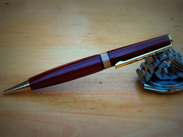

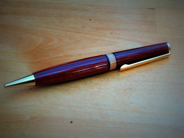

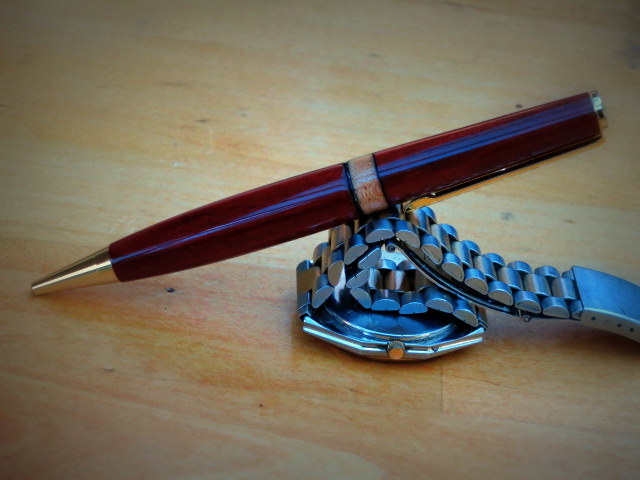

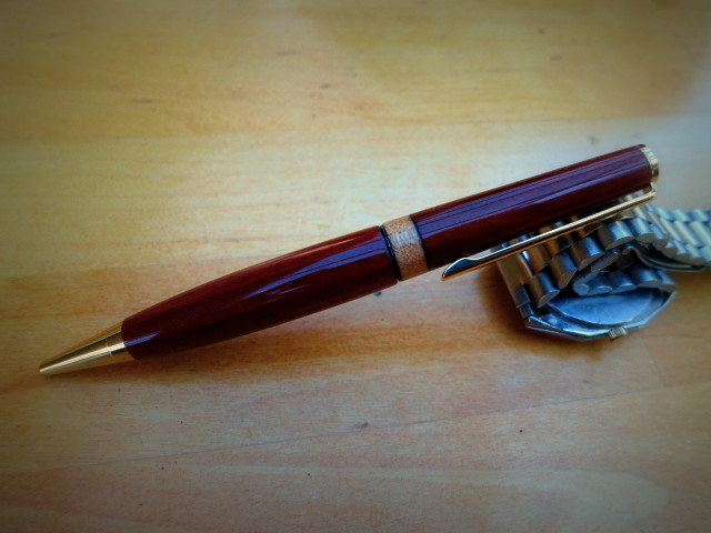

Well, after making my first two slimline kits I got fairly tired of the standard slimline form and especially the center ring, which in my kits is just not that great. So I looked around here and elsewhere online and found an idea for a "Fatline", which is a fatter form using a slimline kit. I tried it yesterday and came out with this:
The CA finish on this one is my best yet. I have watched some Russ Fairfield videos and it raised my CA finish to a new level. I did not do the CA/BLO (don't have any BLO on hand), but will try it later. This one is just glassy shine. The pictures don't capture it all the way, but this thing is GLOSSY! The shape got away from me a bit, I wanted the top part to be a bit fatter also, but this pen is also the first one I made with a skew instead of the spindle gouge. I only used a roughing gouge to round the blank, the rest of the work was done with a skew. So the top part got away from me a bit practicing my skew skill. Still, a very handsome pen and I am glad I can make something other than a standard slimline form.
Really learned a lot making this one. Thanks, all for encouragement and suggestions.

Congratulations on the Centre Band, OK it did get away a bit but a Great Effort, you will nail it next time.
Your Finish looks Superb, and obviously you are delighted.
On the Photograph, it looks like you could have tapered a bit more to the Nib.
Do you use Calipers, or do you turn to the bushes?

The center band is made out of maple wood I had left over from my pen #2. I also used a wire to burn a line on either side of the maple.
I turn to the bushings without calipers and yes, I could have tapered a bit more at the nib. Still, the pen is pretty nice (the finish goes a long way to enhance the overall look and feel) and has served as an amazing learning experience. It also did not take me nearly as long as the first one :) I meant to have a fairly fat barrel, but all the way up to the top. As I said, the top got away from me using the skew and I had to correct some things by taking more material than I intended. I am okay with that. Failure is part of learning and if there is no failure, there is no learning. I am still pretty happy with the result. Some lucky family member will be pleasantly surprised this fall with a new pen...
