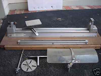

I was going to use Skiprat's idea and adapt it to be used on my mill but a couple of weeks ago I picked up an old wood turning attachment for a power drill from Ebay (photo 1). It cost me the princely sum of $20, couldn't have bought the aluminium need for that!

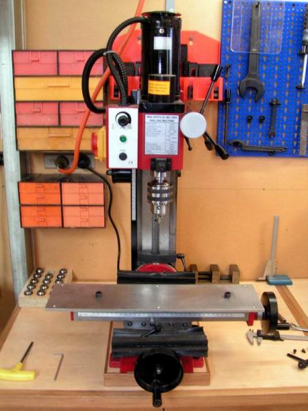

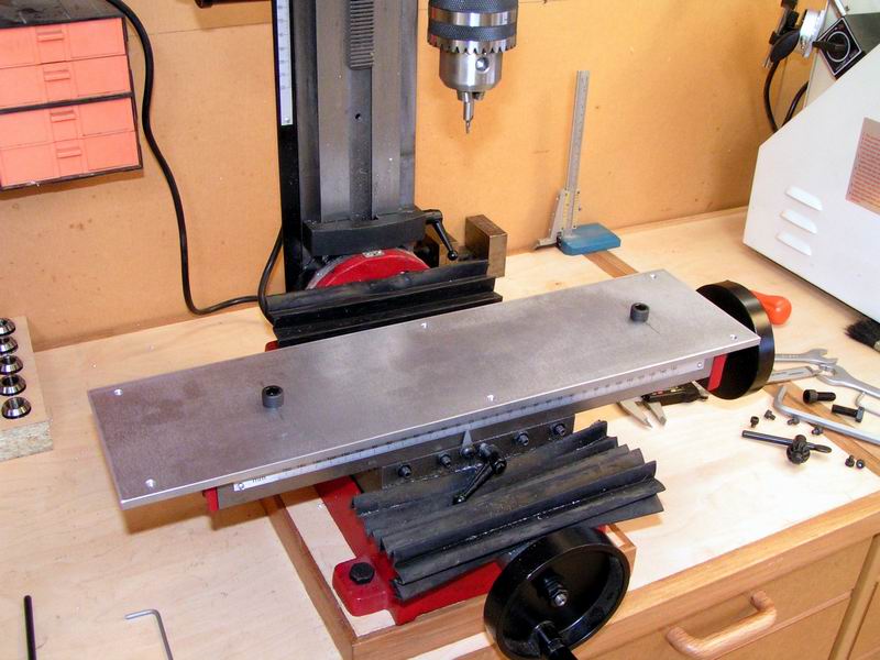

As the overall length, even after I cut the attachment bed in half, exceeded the length of the mill table I had to provide a base plate which attached to the miil and in turn takes the pen mill attachment (photos 2 & 3)

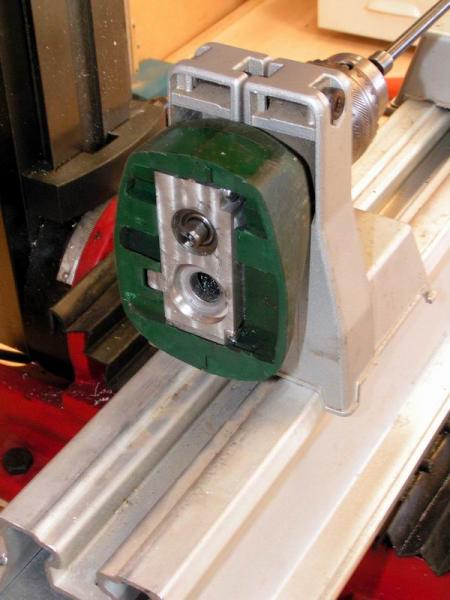

As the turning attachment was designed to take a 42mm collar of a power drill I decided to use the front part of an old, dead, Bosch drill that has been kicking round the shed for years (one day...........). I cut the front of the drill off just behind the gear box and milled the whole thing flat.
(photo 4)

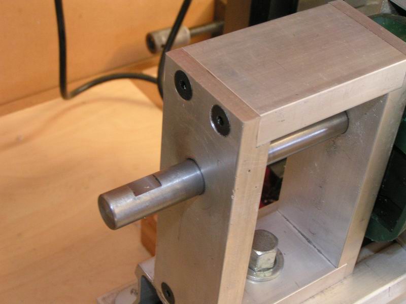

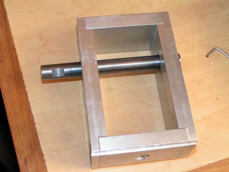

I then made up a frame from 40x12 aluminium to take a 12mm shaft which has been drilled with an 8mm recess to slip over the Bosch drill shaft and attached with a 3mm grub screw. (photos 5 and 6)

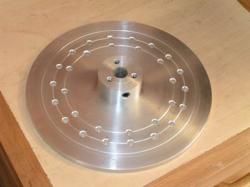

Next was making a 6mm thick aluminium plate, turned to 160mm diam on the metal lathe, fitted with an aluminium bush and attched to the 12mm shaft with a grub screw (flat milled on shaft).(photo 7)
At present there are 2 sets of index holes in this dividing plate, 1 set of 12 and 1 set of 18, have another groove left for another set.

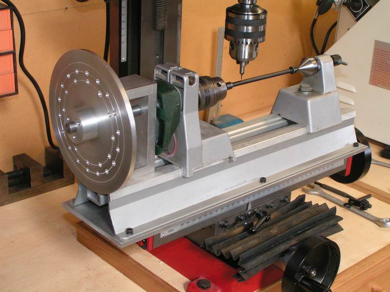

The whole thing fits together quite nicely (photo 8), next step is to mill some logitudinal grooves in pen blanks, or flats, and start playing.

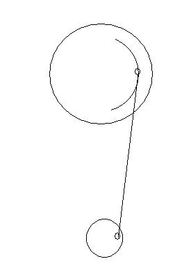

When you get around to extending the leadscrew and adding gears, then you should make a simple goluiche (spelling??) crank at the same time.
You know how an old steam train has the links between the wheels? Just like that, but using the holes in the index ring to vary the pitch of the wave pattern. I know that is not well explained but I'm sure you understand. I could draw a sketch if you want.
Again, very well done:biggrin:
OK, still in time for an edit:biggrin:
In the pic below, imagine the big wheel as your index ring and the small wheel as your leadscrew. a full revolution of the leadscrew will move the index ring back and forth in an arc proportional to the radius of both of the link connections. Hope it makes sense:biggrin:

Thanks for your sketch, wasn't sure what you were getting till I saw the sketch.
