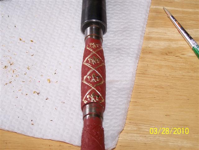

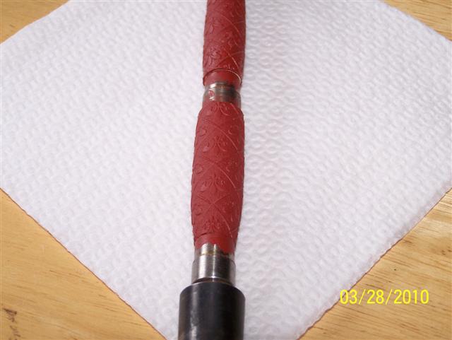

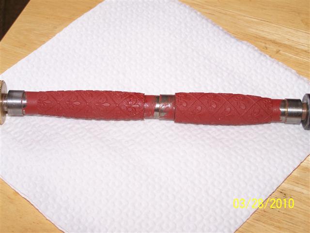

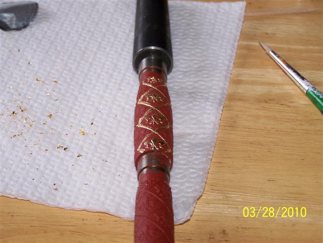

Here is my start on making a fleur-de-cav
Hopefully, if my mind is still together, it will be gold leaf on a marroon background. Sort of like a Ken's Steak House Salad Dressing logo.
Would that be correct Charlie?
Trying to "paint" on the adhesive is "real fun".
Using a fine bristle brush, and 10 power magnifiers

Jerry, far be it for me to be critical cos I certainly don't have a steady enough hand to try that, but if you just want the adhesive on the raised edges perhaps you could smear a thin layer of it on a flat surface, like glass. Then roll the blank over the surface?:confused: Maybe even loosen the mandrel nut a bit and use that to hold it.
I wonder .. it's got to be a little difficult by hand. There's a reason gold leaf costs
a fortune.. and it isn't the cost of the gold.
It's certainly got the contrast and the gold stands out like crazy! And yes, I think
the Ken's dressing was maroon and gold.
(for those who think we're nuts, we were at the BBQ/Regional Meeting and people
were pointing to the logo on a bottle of Ken's Steak House salad dressing and
pointing out the "Fleur de Cav" on the label.
Wonder if we could sue Ken? Or should Cav do it?
Just came up from trying the roller method on a block of corian
The adhesive I have spread out nicely, but does not have enough adhesiveness to stick to the corian, and too much to itself, so that it caused bubbles which filled in a few of the recessed areas.
I am going to let it sit for a day, then retry tomorrow.
The adhesive is supposed to loose its tack after 12 hours.
Thanks for the idea skip.
I had thought about doing that the same way I lube cases for resizing, but figured the pad I was going to use would be too soft.
SHould have remembered the plate from the days of making ink posters
Jerry

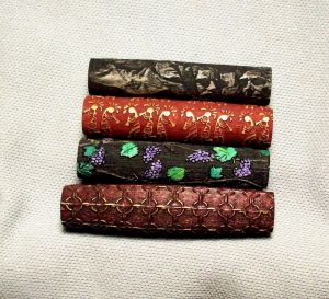

Here are a couple new blanks. Rushmore and Grapes. These will head to Exotics in Monday's mail. Rushmore is low relief so you paint the tube the primary color, wait until dry and sand very lightly off the lathe. I use 800 grit because you do not need to take much off for the detail to show. Grapes was painted mostly with a dry brush and the vines done with an eye shadow applicator which is a sponge on the end of a handle. Very dry paint and just lightly touch the applicator. Not a big deal if you hit the background. Reapply the base color with a brush. Hopefully I will get some CA on a couple of these tonight to for SOYP section. We burned around 50 blanks, so guess what I will be doing later? We are trying to keep dust out of the laser, so I turn and Charlie burns.
