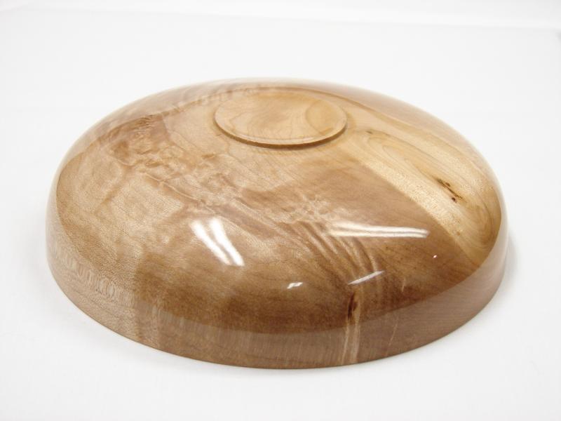

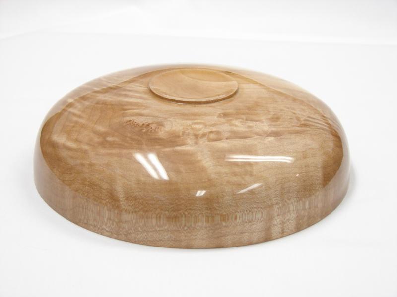

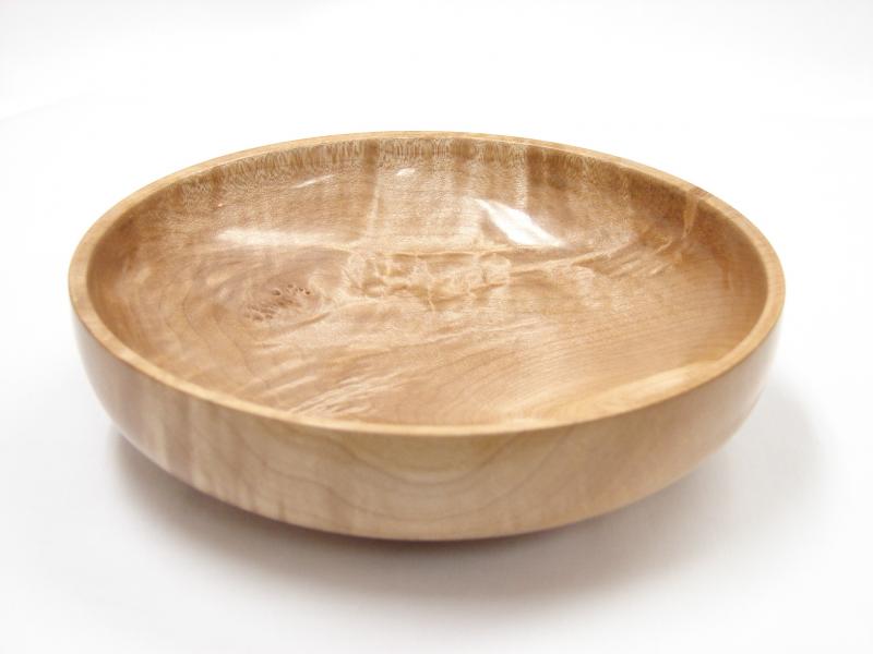

Tiger Maple finished with 6 coats of Minwax Satin Wipe-On-Poly and polished with Hut Ultra Gloss. Measures 6-1/2" X 2-1/4" with 1/4" wall thickness through out.
Still don't have the correct chisels for bowl turning. Used my 3/4" roughing gouge and 1/4" round nose scraper. Will have to get the proper chisels for bowl turning on my next visit to LV.
As always comments and or suggestions appreciated.
Thanks for looking.

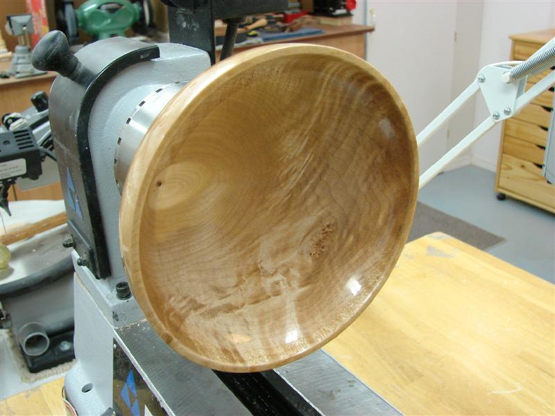

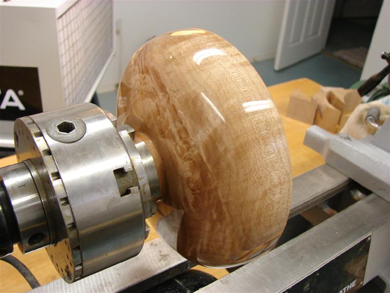

dang les, that is purdy. how do you apply finish to the bowl? i always have trouble getting an even poly finish on bowls.
Thanks Andrew
1. I apply my Minwax Wipe-On-Poly while bowl is still on the lathe @ 500 RPM
2. Fold up a piece of Blue Shop Towel to a 2" X 2" pad
3. Dip the pad into the Poly
4. Make one pass from tenon the bowl edge
5. Stop the lathe and rotate by hand for a few minuets.
6. Start the lathe
7. Dip the pad into the Poly
8. Make one pass inside from bowl center to bowl edge
9. Stop the lathe and rotate by hand for a few minuets.
10. Remove the chuck with bowl attached and set aside to dry 4 hours.
11. Reinstall on lathe and rub down with Super Fine Steel Wool
12. Wipe down bowl with Tack Cloth
13. Repeat steps 1 through 10
14. I apply 4 coats of poly and rub down with steel wool between coats
and the last 2 coats without any steel wool rub down.
15. Polish bottom and inside of bowl with Hut Ultra Gloss

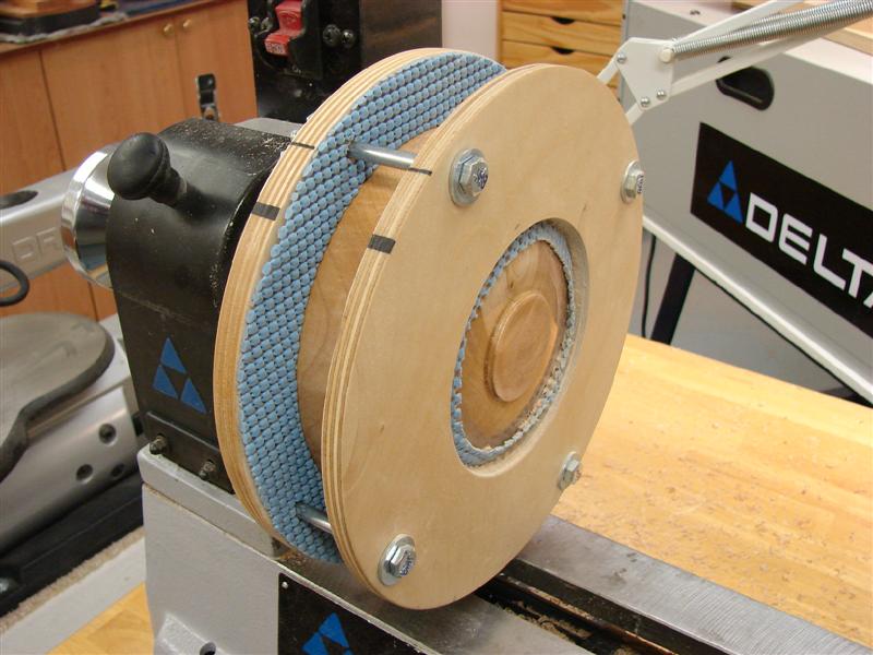

16. Remove tenon, make foot, apply poly and polish.
