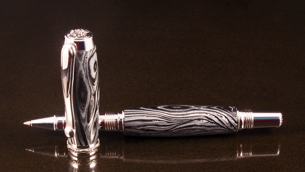

My second Black & White M3

This is on a Jr. Statesman. I really like the fit and finish of this kit. The M3 blanks are easy to turn using a Woodchuck or other carbide tool. I turned it down to size and then wet sanded with 1000 grit with the lathe off. Just to make sure it's nice and smooth with no turning marks. Then I hit it with the metal polish and it shined up very quick. It's very easy to finish these blanks.
They are a bit pricey and certainly not for everyone, but those who seem to like them really like them based on my experience. They have that modern clean look to them.
