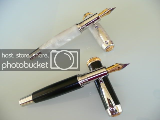

After what seems to be forever I have made a couple of pens for the youngest son's recent wedding, taken me ages to get to post some pictures. For those of you who don't know I have relocated to NSW from Queensland

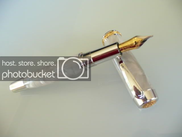

The brides pen is a blank from CSUSA,called white marble and I used the nickel tubes to prevent the tube showing through.

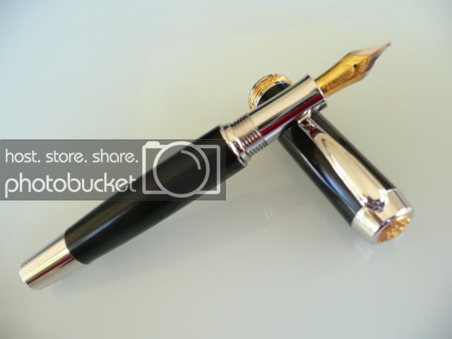

The grooms pen is made from water buffalo from CSUSA I imported as a trial to see if it was possible to import.I aso used the black tubes on this one. Buffalo horn can have flaws in it and sometimes has grey and white streaks.
Both pens were sanded and polished up to 12k mm and then McGuires auto polish and finally brasso paste.

Great pens and a beautiful couple!!!:biggrin:
I hope you have more luck than me with the Buffalo, I've made three different pens with it and they have all cracked about a year later.
The pens did come out great. Nice work. I like the white marble alot and was wondering is there such a blank called black marble that has that marble effect but in black???

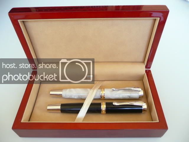

Nick the boxes are available from here http://timberbits.com/catalog/product_info.php?cPath=3&products_id=173
David has lots of different boxes for presentation and display at reasonable prices I am sure he is a member here as well. He has hi pens on display in the Dayacom boardroom. How's that for bragging rights
the white one is spectacular..the buffalo horn : I have never made one that didn't crack sooner or later ..I understand that someone stabilizes these now because of that problem...
