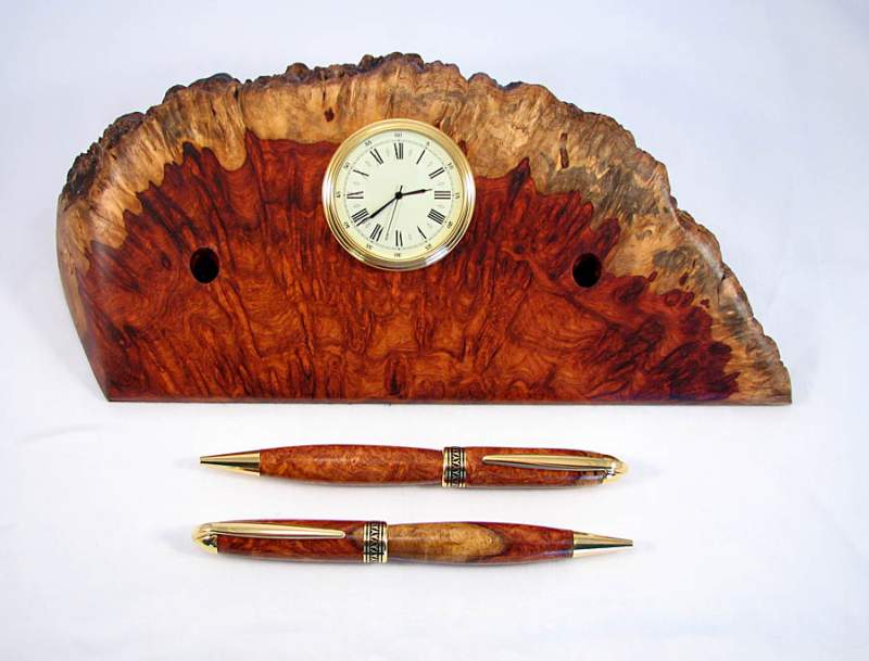

I've been working on this desk set for a customer who fell in love with a set of Amboyna pens I made him... he had to have a desk set. So I looked and looked for amboyna that I could afford and that fit my requirements, finally found it (and another piece which is to-die-for too), and here it is... done at last and getting ready to be shipped to it's new home. I'm really happy with it! :) Here are views of all sides:
Would love to know what you think.... please be honest. If I could have done something differently to improve it, please point that out. I had a hard time deciding at what angle to drill the pen holes but decided on vertical to show off the pens better (drilled at a right angle to the face of the slab would have shown nothing but the tops of the cap of the pens).
Details: Finish on slab is mixture of tung oil, linseed oil & polyurethane (a la David Marks). Pen finish is my usual with the addition of a few coats of thin CA before the MM. Bottom of slab is covered with black felt (tediously cut to fit the amboyna's natural edge), pens are 10k gold Euro Deco clips from CSUSA (I hope more come in soon, Nils!). Clock is solid brass from Steebar.
Thanks for your input...

Nancy, this set up is fabulous to say the least, I am trying to do the same thing but with a piece of maple burl I found. You have truelly done a beautiful job and the only thing you could have done differently was send it to me of course. By the way, how did you finish the base, I am stuck not knowing how to do that part, I already have the pens done and the shape of the base. Did you drill the holes before or after you put the finish on?
Great job [:)]

Thanks so much, Janet. I bet maple burl will make a gorgeous set!!
Finish on base/slab is mixture of tung oil, linseed oil & polyurethane that woodworker David J. Marks uses called Arm-R-Seal, made by the General Finishes Company and available through mail order as well as from Woodcraft. This stuff leaves an absolutely BEAUTIFUL finish on everything. It's my favorite.
I drilled the holes before putting on the finish, yes. But, I did have to tweak the holes/wells after the finish was done because some of the polyurethane had run into the wells and I hadn't blown it all out while it was wet. So I reamed them again slightly for a perfect fit when the piece was all done and the finish coats were all dry.
Hope this helps.

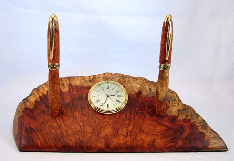

I really like the set. The wedge slab really gives the set a different look that I find very distinctive. I am slightly unsure about the angle of the pen wells, but would NOT want to experiment on such an incredible piece of burl.
With respect to the bottom, did you consider the felt that comes in rounds with adhesive on them? Maybe I'm lazy, but that seems far easier than the cutting out you had to do.

Thank you very much, William... I thought about the little round felt dots, which would also have shown some of the lovely wood on the bottom... I'm not sure why I decided to fully cover the bottom, really. I guess I thought it might look more "professional".
Pen angle was a toss up for me. I held those dang pens at every conceivable angle for hours. LOL Ended up this way to display the pens' wood better, otherwise I probably would have drilled them perpendicular to the face angle.
