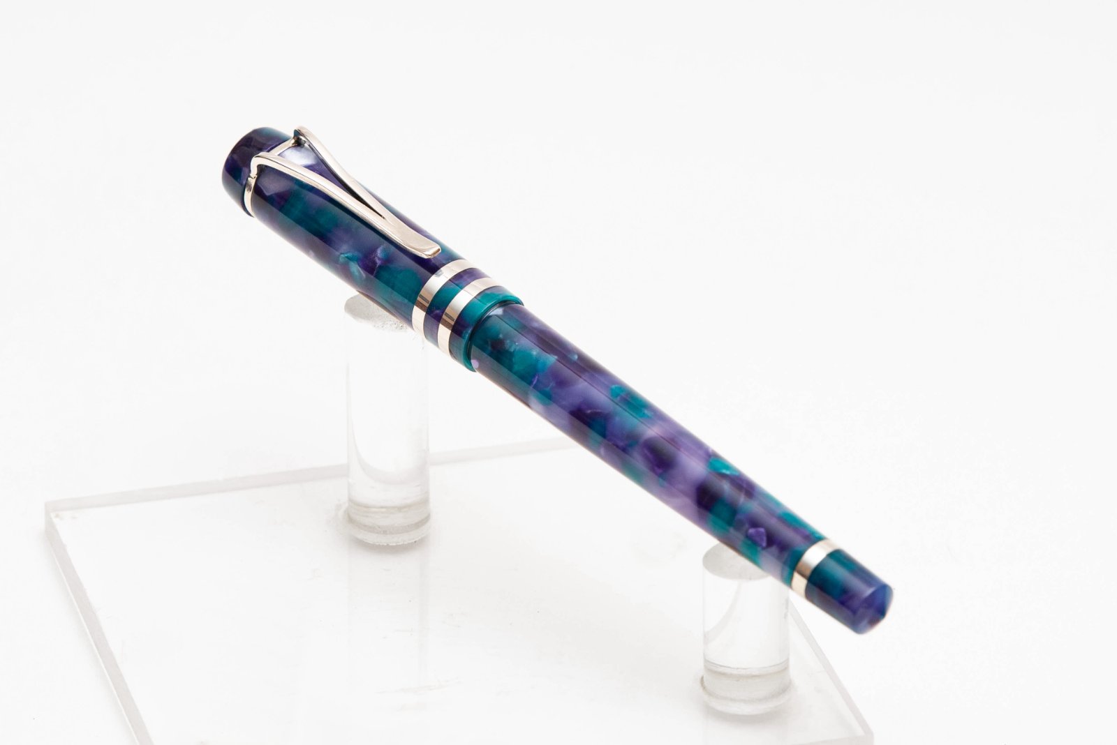

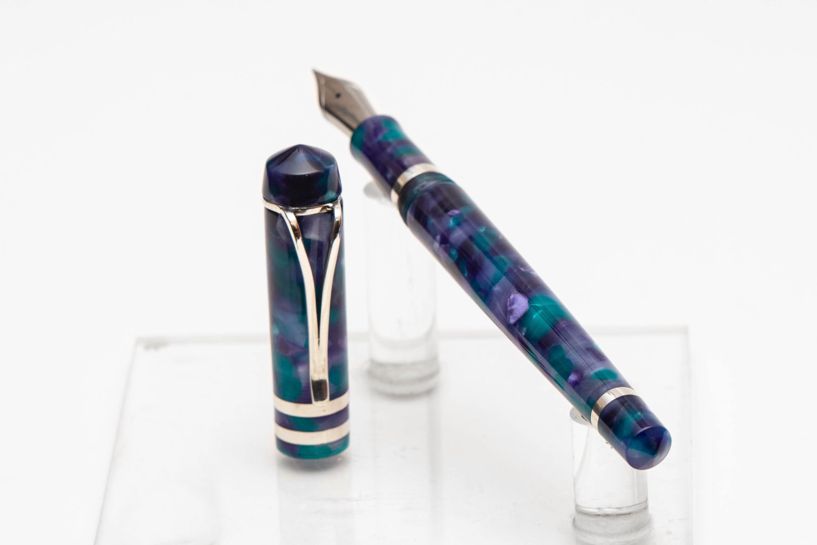

This one turned out really cool by accident. I made the bottom silver ring smaller than I had planned, but didn't realize until after I had swaged it on. So when I turned the barrel, I made it a straight tapered shape. It ended up looking really cool, so I continued the shape with the cap. The result is that it's widest point at the clip ring is 13.9mm and then it tapers down to 8.9mm at the bottom. The downside is that while you can post the cap, the barrel is too narrow to actually hold the cap in place. The shape of the silver clip really accentuates the taper of the clip and barrel.
Length: 139mm (~5.5")
Width: 8.9mm-13.9mm
Threads: Cap/Barrel - M12x0.75, Section/Barrel - M9x0.75, Finial/Cap - M9x0.75
Material: Conway Colors Azure acrylic and Argentium silver.
Nib: Steel Jowo #6
I love the profile, elements, turning and finish. I'd have no reluctance to not try and post the cap for fear of marring the finish - Beautiful pen. 👍 👍 👍
