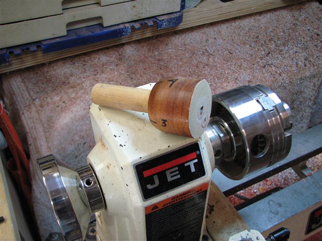

A little scrap wood and a dowel make a nice sanding plate. Paired up with the jacobs chuck and a harbor freight punch set, I can square up any blank or clean up after applying finish with accuracy.
Someone had posted a video on acrylic blanks where I saw something similar being used and I thought...I can do that :) 20 minutes later I'm soooo much happier and can say good bye to the pen mill.
For big removal I'll just use the disc sander to get it close and then use this to finish up.

Yes, it allows me to put it back exactly the way it was turned. That way if there was any slight offset in the way the dowel was glued to the face or any other variance it keeps everything aligned just the way it was turned so it runs true and smooth.

I would love to do this. Is there a link to that video you mention? I also had a couple of questions.
What grit sandpaper do you use for squaring?
I am not sure I understand the hole in the end where the sand paper goes. Why is it there?
Do the HF center punches flex at all when using them like that?
Thanks so much for the idea!
I'll have to dig back through some facebook posts to find the original video but it was related to casting and/or turning acrylic blanks. Just happened to catch a setup similar to this towards the end with really nothing mentioned about it specifically.
The hole is where the punch tip of the punch sets into the face. Keeps everything from flexing...not that you need to put much pressure on anyway. Just slight downward pressure to cover any slack if the punch is not a perfect fit to the tube..then press into the spinning sandpaper for a second or so at a time then back off, clear the dust and check your progress...repeat until desired results are achieved. I run this at the lowest speed I have.
That's 220 on there now. I might make a second one with a lower grit for fast removal pre-turning and then have the 220 in there for finish work.

Actually it's pretty much permanently mounted into one of my collets and I just put the collet chuck on now instead of the nova. Quick screw on/off and it's accurate every time. Definitely turning a taper on it would work as well.
I've gone to a method that uses a low grit paper on a disc sander to get just to the first touch of the tube, then I'll put it on the punch on the lathe to square it up proper with a bit higher grit paper. I have fairly large rolls of PSA paper from Klingspor that I just tear little pieces off and stick them to the face. No use cutting round paper as it just wastes time. As long as it's big enough for the blank it's good.
When the face gets gummed up with psa adhesive, I'll just true up the face again with the chisel for a nice fresh surface.

I took Curtis's advice and am using my face plate attachment and cut a plywood circle and attached to the face plate then added the hook side of velcro to it and use 100 grit sanding disks works perfectly with my HF centering punch set.
