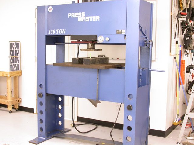

Here's a picture of my latest piece of equipment. It should have plenty of oomph for those pesky sticking pen parts. I hope to do some forming and stamping with it. I hope to also get into making mokume material with it.
Fortunately, the table lowers down. Unfortunately, I got it used and the cable to do that is broken, so I have to rig it all up to work again. The cylinder is massive. Maybe around 12" diameter by something like 16" tall. It has a 12" stroke.

John, I had to go in PhotoShop and color the pen blank a little green to be able to see it. [:D] I just ordered a 4" diameter chunk of stainless steel so I can make a clean press face instead of the bent 1" steel piece welded to to a press face in the picture. They get setscrewed in place.

I just wired it up and ran it for the first time. I was a little nervous that the motor might run backwards. There were no arrows anywhere to indicate which direction it should be running. It seemed to be pumping oil correctly. It goes very slowly, but it crushed a paint can cap before ever reading anything on the gauge. Next, I need to make some punch and die sets for earrings.

It looks like the press is slow enough, around 4 seconds per inch or so, that it gives plenty of notice to get the fingers out. The ones to worry about are the mechanical ones that stroke several inches in a second, where you may not have time to react. I've seen a factory that made the paper towel dispensers that I worked on have those. The operator literally was shackeled at the wrists. A cable forcibly yanked the hands out of the pinch point if the ram was to move unexpectedly. He had to have his hands back and raised before hitting the pedal with his foot. Talk about being chained to your work!
