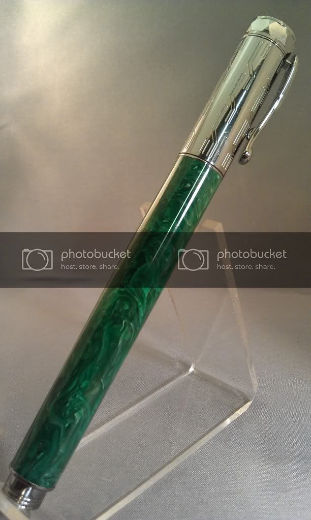

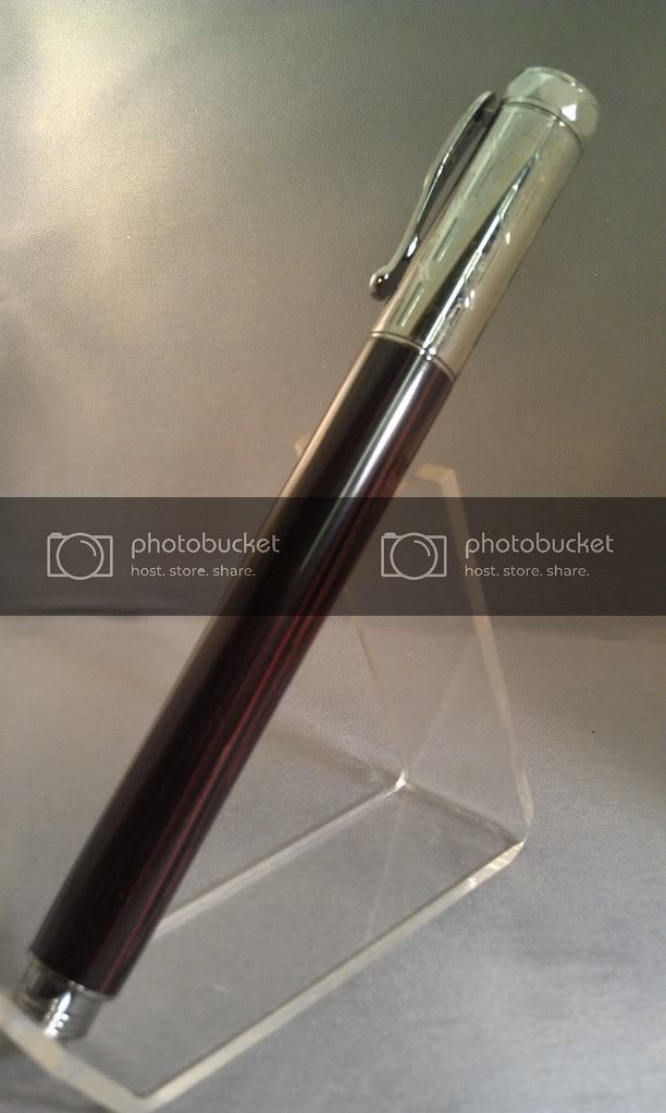

M Manny Member Joined Jan 15, 2009 Messages 854 Location Rancho Cucamonga, Ca. Aug 2, 2011 #1 Ebonite red/black on a stretch with a fine nib Next is a Green bakelite stretch with a broad nib Thanks for looking
simomatra Member Joined Apr 22, 2007 Messages 815 Location Aberglasslyn,NSW, Australia. Aug 2, 2011 #2 Two more beauties Manny, I love those kits they really make a statement. I take it that they are FP's?

Brooks803 Member Joined Sep 13, 2009 Messages 5,632 Location Aiken, South Carolina Aug 2, 2011 #5 They both are great Manny. If I may ask, what finish did you use for the ebonite? It has a warm shine to it. I just made my 1st stretch FP and it's really nice to write with, I'm sure you'll enjoy these 2. Great work!
M Manny Member Joined Jan 15, 2009 Messages 854 Location Rancho Cucamonga, Ca. Aug 2, 2011 #6 Jonathon, Ebonite finish Sand through 400 cross sanding after each grit micro mesh through 12000 cross sanding after each grit EEE Novus polish Thanks for looking
