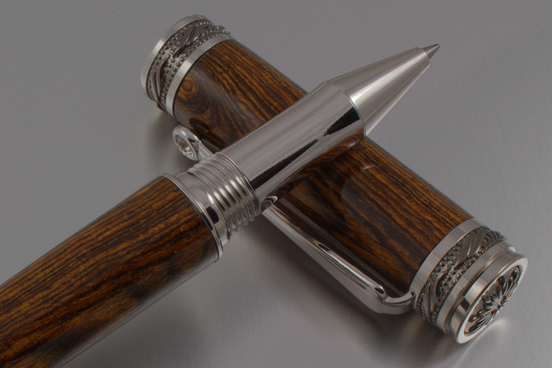

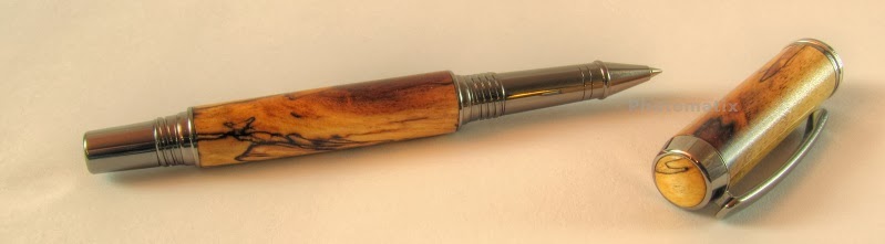

Tonight I tried HDR for the first time using PhotoMatix.
I'm using a Canon SX130is. I downloaded a firmware hack to make this point and shoot do auto bracketing with one shutter press in conjunction with the 2 sec self timer and 3 shot continuous mode. If you have a Canon point and shoot, Google "Canon CHDK Richart Smrt." Watch Richard's video, then download the firmware hack and have fun. And it's not my fault if you brick your camera. All I can say is it worked for me. This hack also enables RAW and time lapse on Canon point and shoots, but it's already late enough for one day, so I'm going to bed and will try that another day.
My camera only goes up to f 8.0 so that's where I set it. Turned Image Stabilizing off. Bracketed the exposure at -2/3 0 +2/3. ISO at 800, as low as it will go.
This is leaps and bounds from where I was just 2 days ago. To continue improving, I am going to try bracketing at different values as my next step. I also need to get the white balance right so that the background appears white, as it truly is.
What would you guys recommend?

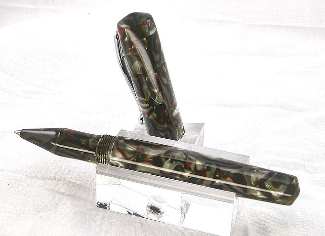

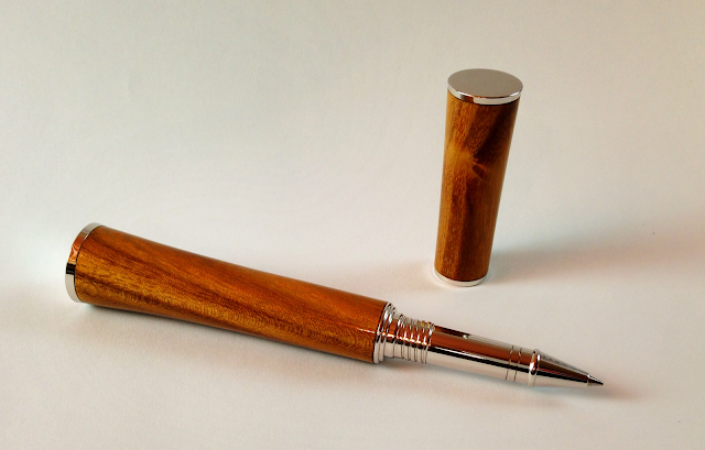

And by the way, this is my first Jr. Gent II and my first custom finial. It's spalted black walnut with mostly sapwood and a little heart.
Thanks again, everyone!

Seems that the 'AUTO' mode, doesn't quite cover everything. It has it's place, but not in photo'ing 'stock' items where time-n-space can be manipulated in any fashion so chosen by the user.
EV values I used in this topic are just 'suggestions', and are not to be considered as a set in stone type of thing. By all means, playing with any and all setting and use what works for you.
As far as white balance, that can also be manipulated in processing. If you know the background is 'white', then 'tweak' it until it becomes white.

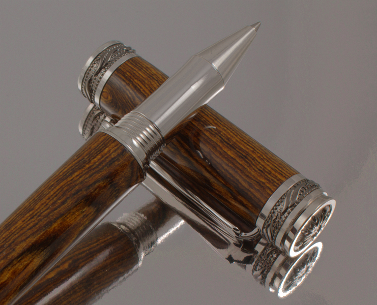

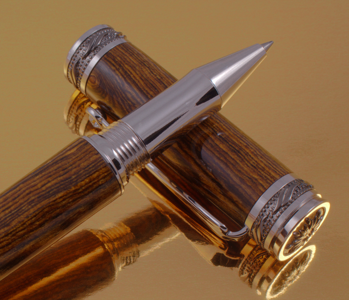

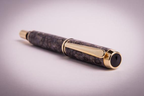

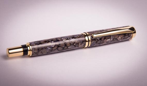

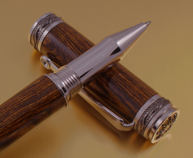

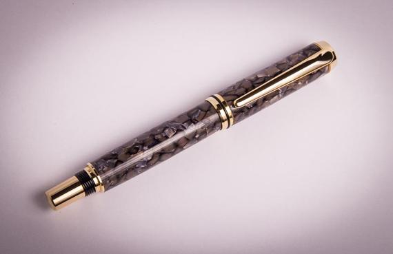

Been following this thread, thought that I'd throw a couple of mine up, let you know my mind-set when doing the pics, and get your feedback.
I'm lucky that photography is one of my hobbies, so I have a few tools at my disposal. I do all these in manual mode, with a single flash behind a white umbrella to make a big soft light source and a reflector on the other side to fill in shadows. Only editing I normally do is to crop and add in the vignette effect. Occasionally I'll touch up a shot, clean up some dust or anything else that got in, but I try and not manipulate them too much.
I usually shoot at F11, on a small sensor DSLR you start losing image quality much below that due to diffraction. Shots are handheld, 1/200th. (That's one of the advantages of having an off camera strobe, you get a TON of light so you can hand hold.
Normally I'll do a full-length shot looking down, that gives the overall look and feel for the pen. Then I'll do a few where I'm shooting at an angle with the focus set on the "key detail" like the centerband, or the wood grain, and allow the rest to go out of focus. The effect is to really draw the eye to the center of interest.
I don't worry too much about metal getting too blown out, the soft light keeps it from being too bad, and I think the effect gives a nice feel for the sheen.
That said, here are some, love to hear your feedback.
Learning every day....
Steve
I'm seeing shadows still...that is one of the advantages to HDR. I do like the added vignette, I still much prefer the HDR effect.
Scott (love those blanks too) B

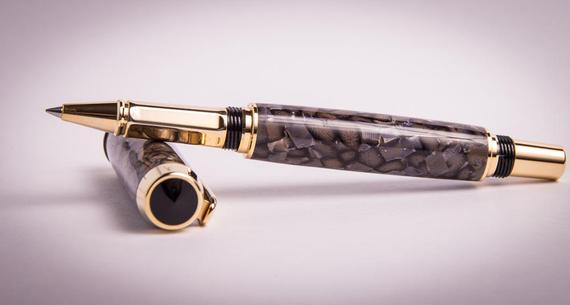

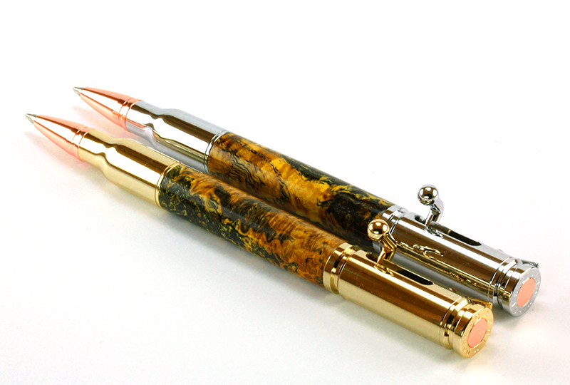

My try
I followed the guidence in this thread and I beleive it has improved my photos some. More adjustments could be made to my picutes but I sure do appreciate the willingness to share techniques. Thanks. And yes, that landscape picture is very cool!
The blank is stabilized buckey burl dyed black and gold from Exotics.
Thanks. I should also give some credit to sylvinite. This thread and some of his tutorials has helped me a lot.
That's a nice picture Mike. Really good depth of field, and realistic colors. Good job.
