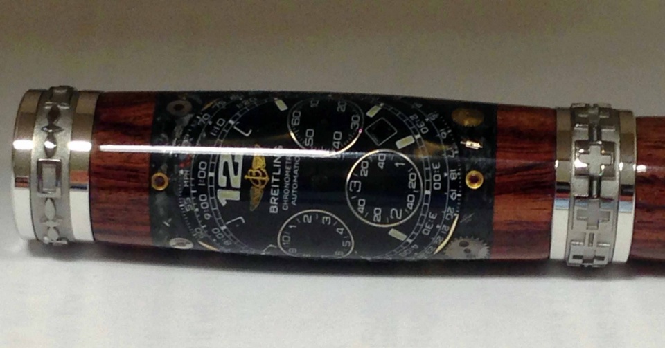

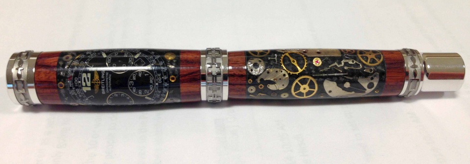

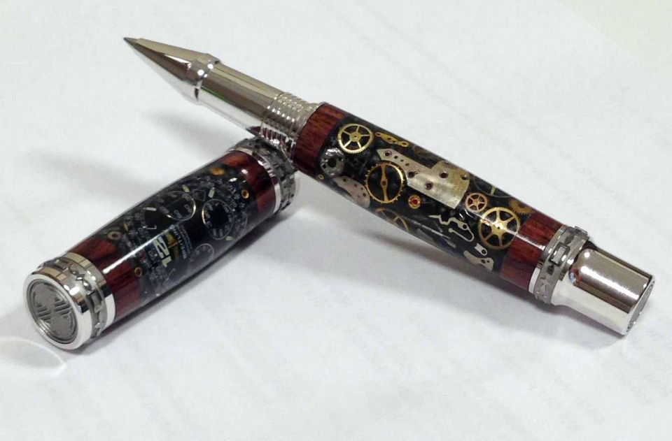

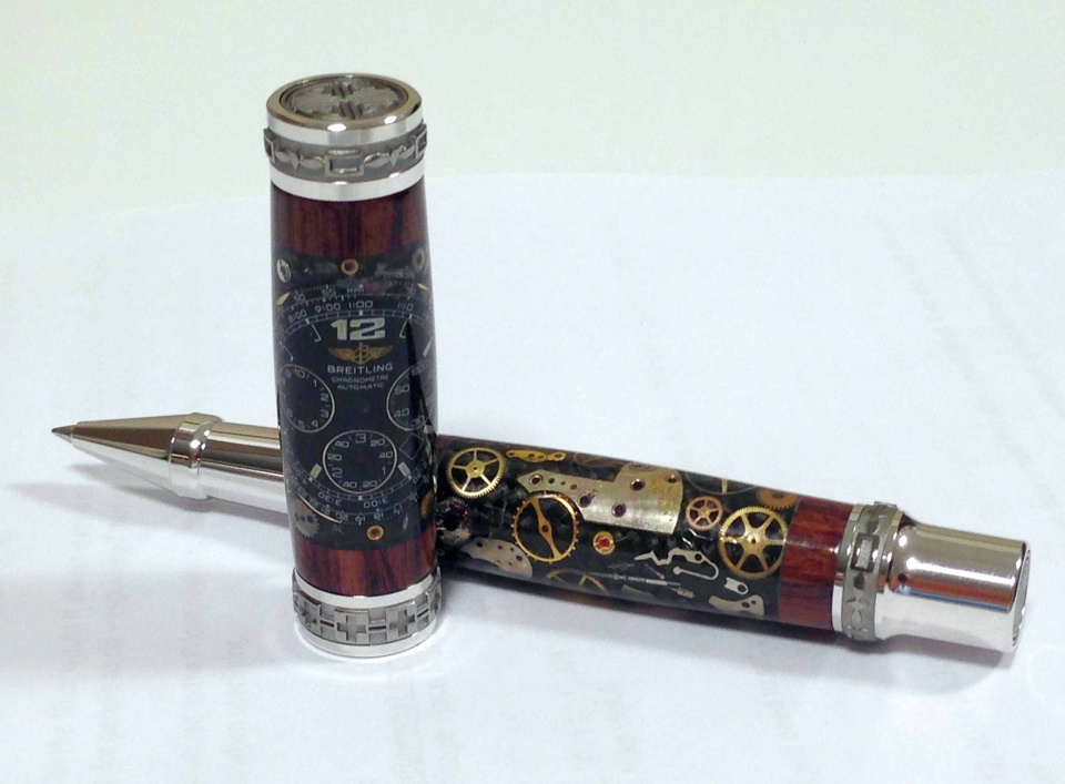

Some things have come up that I will not be abel to attend MAPG later this week. But since I put some time in on this pen I thought that I would go ahead and post it. I know the pictures are bad, some serious glare from the lights, no light tent.
It is a segmented watch parts pen on a full size Emperor. The dial on the watch is a Breitling Chronometer and the wood segments are King Wood. I had started off with the segments being Tonga Nuts, it took one nut for each of the segments. As I started to get the blank round on of the segments shattered. I cut up and sanded 4 more nuts and could not get a big enough clean piece to get another band. I think the King wood turned out okay anyway. The finish on the King Wood is CA.

Mike, that is a beautiful pen! Please describe the segmenting process you used. Did you tenon the carbon fiber cast?
I painted the tubes a flat black and glued on the carbon fiber with CA. Then turned the ends back down to the tube. I made up my pieces of the tonga nut and and glued them on with epoxy. Then glued all the watch parts on as normal and cast in epoxy.
When I started to turn it one of the tonga nut ends just exploded, that is some really hard stuff. I tried four more nuts to try and get another end segment without cracks and finally ran out of nuts. So I turned off the other three and cut and drilled pieces of king wood. I ended up taking off more of the end than I wanted to to get a clean joint.
Glued on the king wood with epoxy and then sanded the ends down on a belt sander. Then it turned pretty good.
