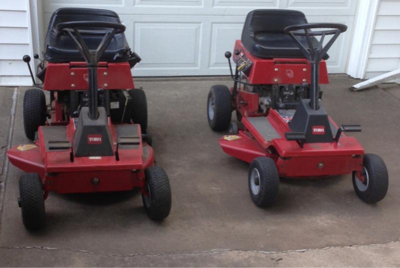

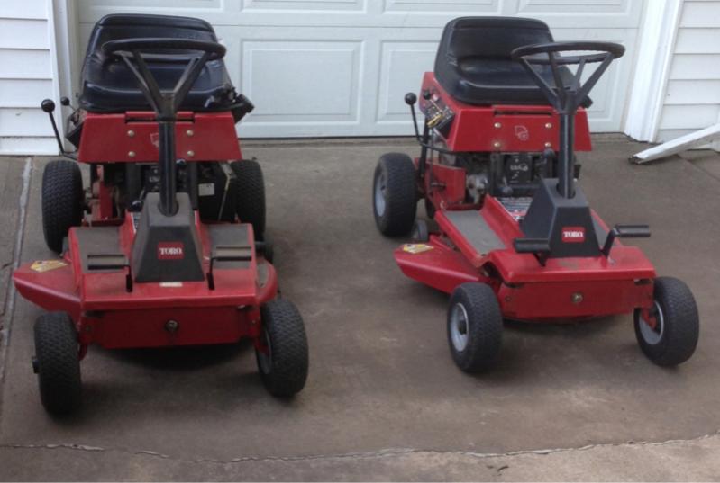

Hmmmm, I guess I'm just lucky. I have had lawn tractor/riding mowers since 1969 (including now) except for 7 years where I didn't have a real lawn - stored them every winter just taking the battery inside and never had a problem with them starting in the spring. I always had them serviced once a year but they always started just fine. They were mostly Wheel Horse but my current one is Troy Built.
Nothing cuts as nice as a good Wheel Horse ... or 2
