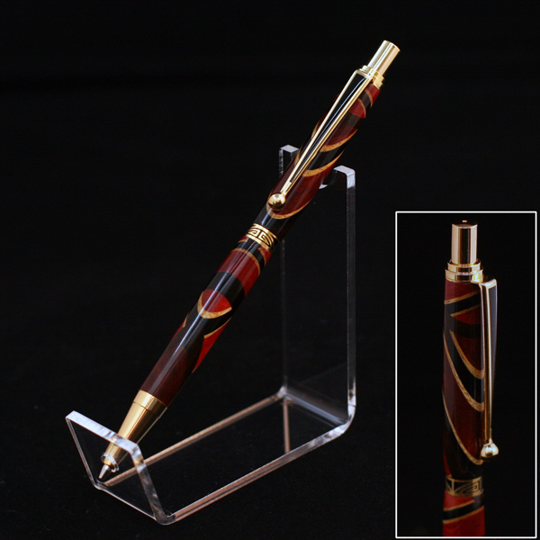

My latest Segmented Series

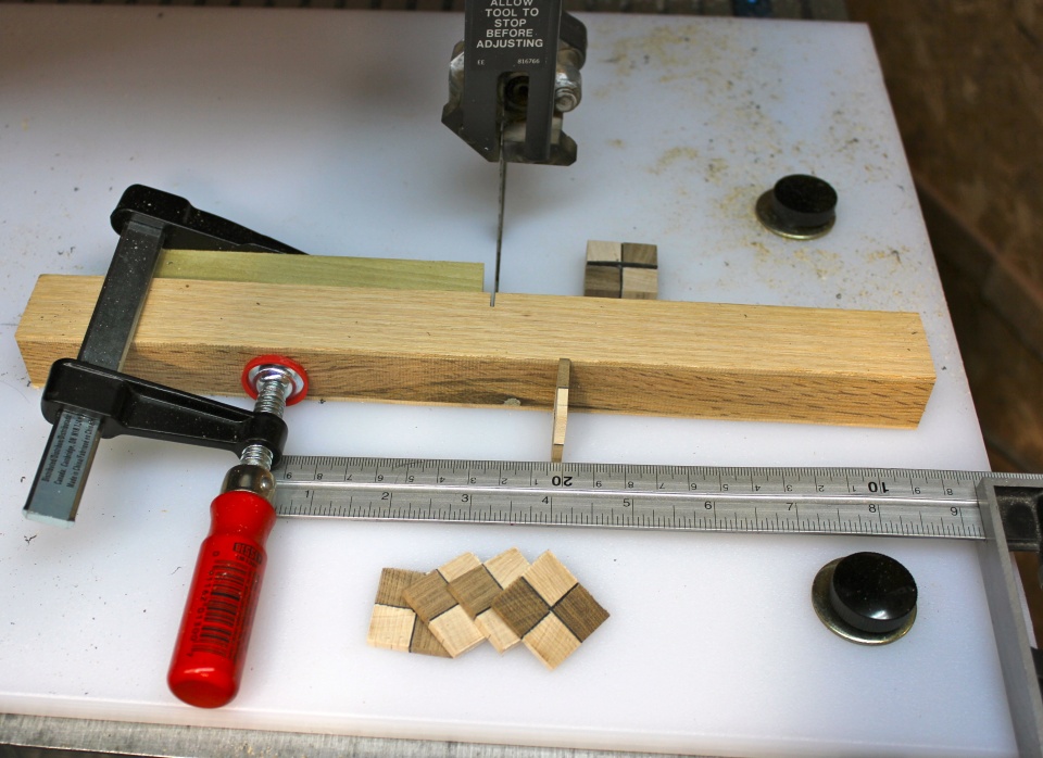

You can make one of the very cheaply with a toilet bowl bolt that will slide into your groove. Just add a piece of wood.
My table saw fence isn't good enough to use one of these, that's why I use the dial indicator.
I had to laugh at your comment Tom... And as I thought... Shoot - he's exactly right! I'm no plumber or carpenter, but I have reseated quite a few toilet bowls!

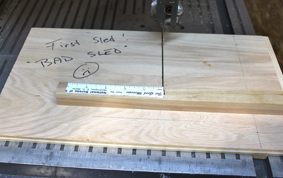

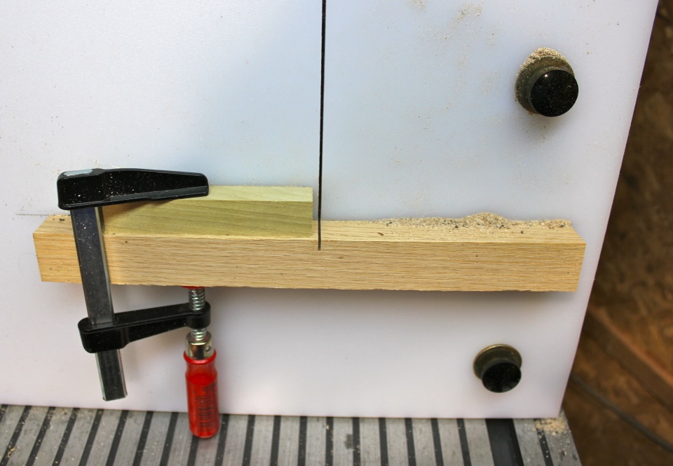

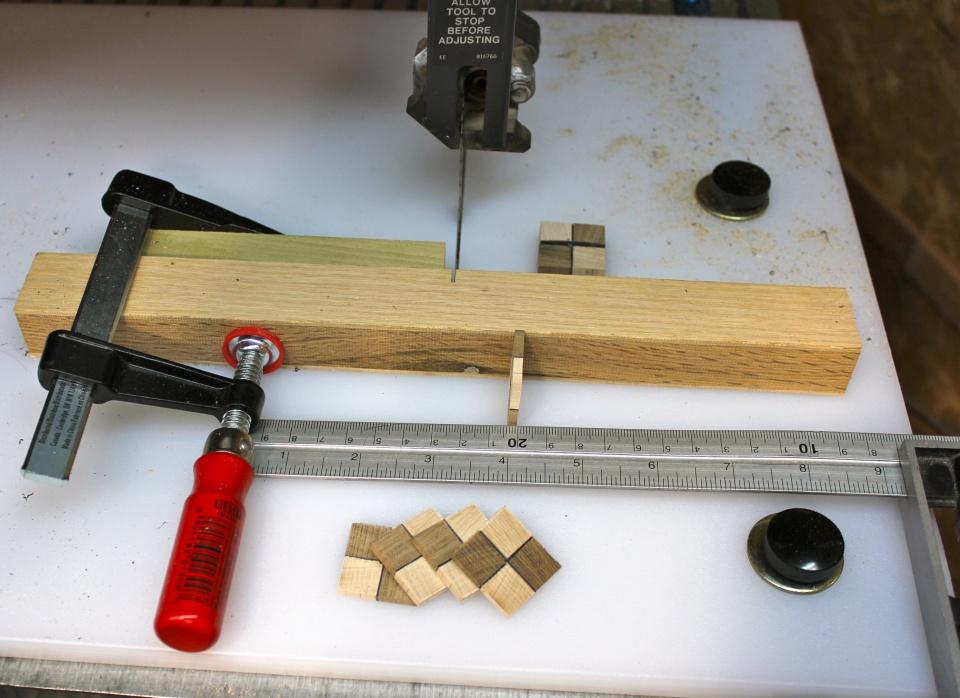

But I use a band saw with good accuracy. This all would be fine with a table saw also.
