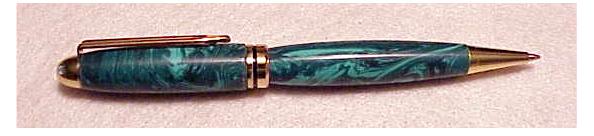

I've turned a few pieces of Tru-stone..... also some Polygem from HUT.. they are similar, but not exact..and the Polygem tends to be much less expensive.. I found one picture of a Tru-stone still in my library... I know I did a Turquoise fountain pen, a Blue Lapis European and a Red Jasper European but can't find the pictures... I know I lost some pictures when I change computers last year...and evidently have already sold the pens...
except for this one - a Tru-stone Banded Malachite European..

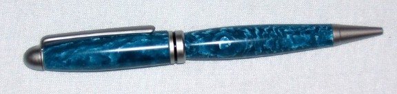

By comparison, this is a Polygem - Aquamarine.. it actually a lot more blue than the picture in the catalogue..
<br />
I don't remember paying so much for the Tru-stone, but that was back a couple of years and haven't bought any lately.
