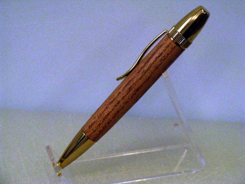

So after receiving a broken drill press and band saw on Thursday, today I ran to HF and grabbed a miter saw box, hand saw, and a MT2 Drill chuck so I can at least start making something.
So I started a Slimline kit and accidentally got the brass tube glued to the barrel trimmer...cant get it off, I need some CA Release or something. So no slimlines for the time being but I also bought 9 Carbara kits form AZ Silhouette as well so I moved on to those.
Worked out much better for me. I still had a bit of a problem trimming the barrells, maybe the Honey Locust was just really hard but I ended up doing it on the Lathe as well...might need a new power drill.
So here it is; a 24K Gold Carbara kit from AZ Silhouette on Honey Locust.
Go to the hardware store and get a pint of acetone. That works wonders when you start gluing yourself and other stuff together with CA...
Off to a great start! Congratulations!

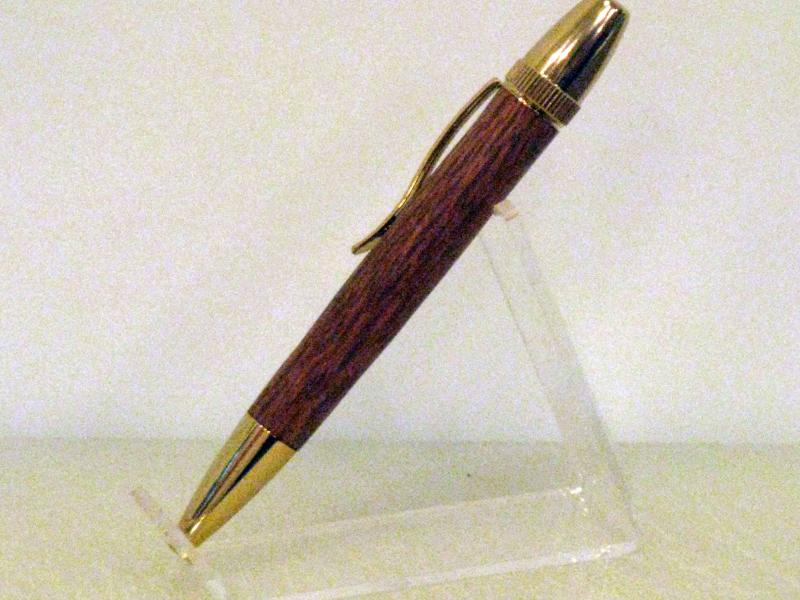

Got one more to show as well:
24K Carbara with Lacewood (From CSue, the Honey Locust was from JClarke58)

I'd leave the pen mill in there..I hate squaring ends with them..they can cause terrific blowouts..if they are at all dull, lookout and can crack plastics...if you find down the road you hate losing blanks, you can do a great job on a sander..this method has served me well for many many years, and I don't lose blanks
