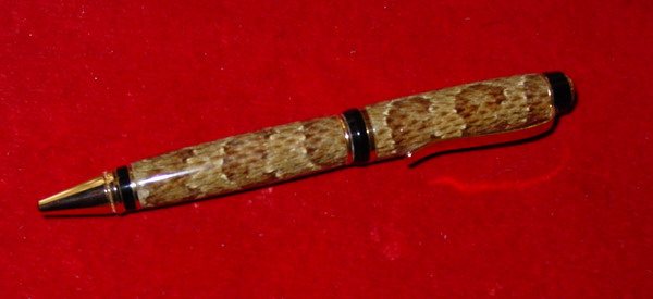

My first Snakeskin pen.

Not easy, but it turned out OK.
Turned out better than okay! Nice job! What don't you like about it?
BTW, welcome to IAP! Nice way to introduce yourself!
Sorry about the photography. What was not easy is that after ruining
a set of blanks I had to come up with a different way to turn them, because I had sold 5 pens. I did not use a tool to finish them , but after making them semi round on my 1" belt sander They were turned with 80 grit sand paper super glued to a 1.5 in x 6" board that I used as a tool to get them close to fit. Then with micro mesh up to 12000 to finish. I hope this helps.
Jack
Jack,
Don't know your background, so PLEASE don't take offense: Acrylic is NOT the easiest place to start penturning!!!!!
After you are comfortable with some tool (gouge, skew, scraper, anything including sharpened wood chisel!), THEN tackle plastics-VERY LIGHT CUTS!!!
But, taking an order for 5 pens you have never turned before is a man after my own heart-CONFIDENCE that you CAN FIND A WAY-and you DID!~!!!
Congratulations!
