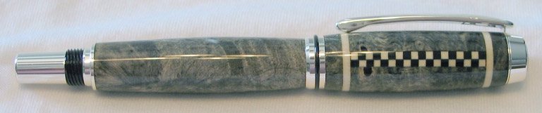

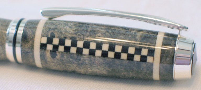

Here are some pictures of my first segmented pen (sorry about some of the pictures, I didn't have the energy to drag out my light tent and lights). It is a sterling rollerball Baron made from Buckey Burl, Gaboon Ebony and Holly with a CA finish. Can you tell what it is? I'll describe what it is at the bottom of the post.

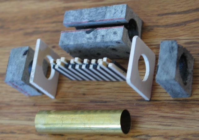

It took me a while to figure out how to make this with the precision that I wanted and without cutting my fingers off. I used my DeWalt sliding compound miter saw for almost everything since I don't have a table saw. Here are some pictures showing how I made it.
This pen is for my uncle who races cars as a hobby. The name of the pen is 'Finish Line'. The buckey is the closest to the look of a street that I could come up with, the white bands are the sidelines and of course the checkerboard pattern is the finish line (it only shows on one side of the pen). From what I've heard and read Gaboon Ebony is the blackest wood out there and Holly is the whitest so that's what I used.
I'm pretty happy with it. If I was going to make another one I would adjust the proportions a little to make it look closer to a real race track.

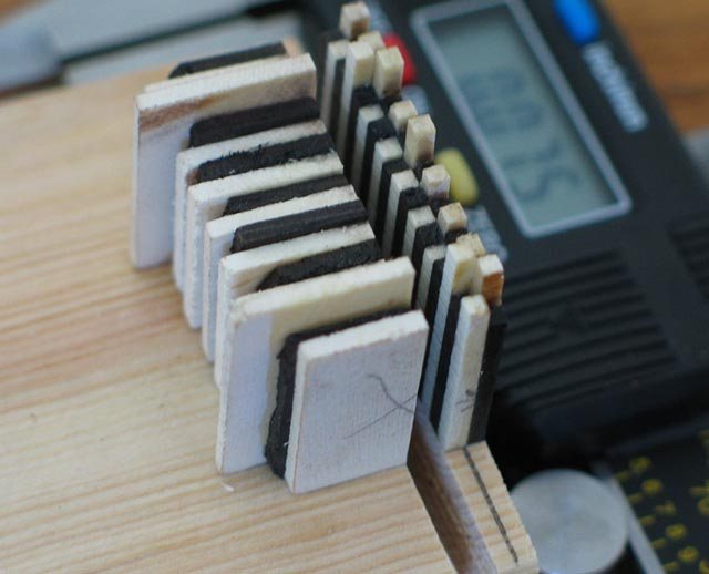

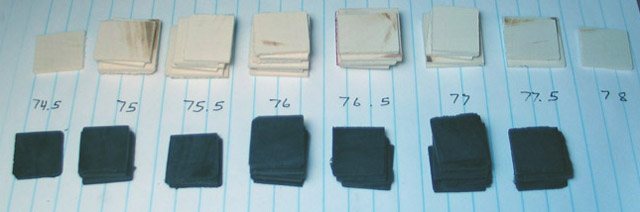

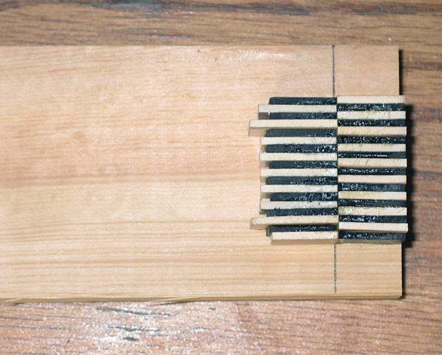

I have been tinkering around with different ways of making this pen for a while. My first couple tries (band saw and cut by hand using a razor saw) did not work. I couldn't keep the cuts accurate enough to keep the checkerboard pattern lined up. The squares are 0.075" on each side and any variation caused the pattern to drift. I finally setup a jig on my miter saw and sliced up a couple of Ebony and Holly pen blanks. Here's a picture of the result.
<br />
The piles in the picture are the slices sorted in groups measured to 1/2 of a thousandth of an inch (thanks to the great deal from Harbor Freight on digital calipers that I learned about hear on IAP). I only used slices that were all +- 0.001" of each other and the pattern stayed in line!
I made sure to get the cuts on the glued up stack right on the first try. Not sure how much time I spent on it overall but the glue up could be done in a couple of hours now that I have it worked out.
