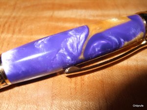

My first polester resin blank
See more from Chilprufe
That's a cool combo! A little more mixing IMHO to even out the carmel in the slurpy. Great blank no matter how many you have under your belt!!
Ye ... could of done with some more mixing but i was a bit slow with adding the gold mix to the violet as it had gone off a bit too much for mixing
