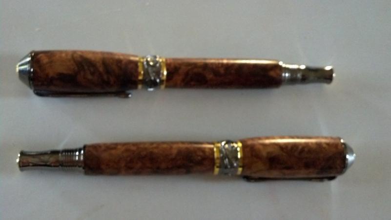

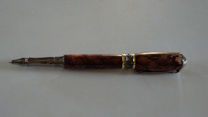

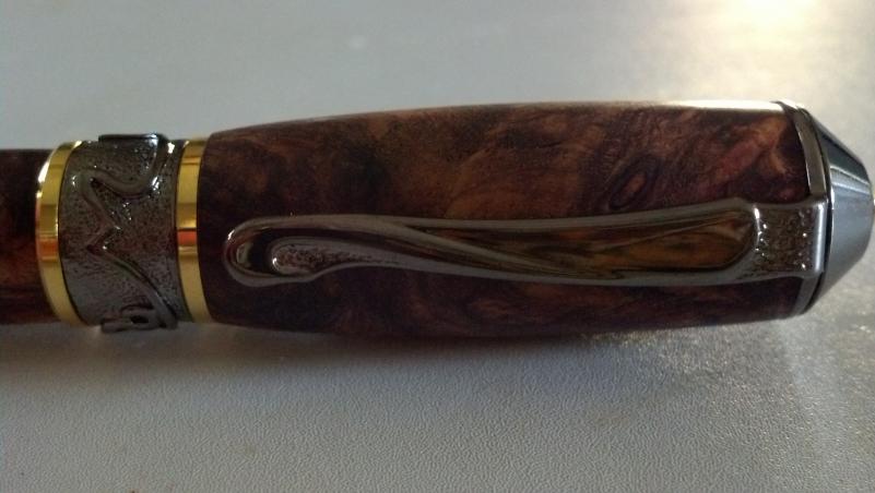

hey I've pen making pens for about 4 months but this is the first one I've posted on here so tell me what you think, good or bad.
this is a sceptre pen done in a honduran rosewood burl
Good job matching the materiel to the kit. Sometimes figured wood and fancy kit can clash but that combination works. Something that can help is using a set of calipers to measure the hardware and a few points along the blank to check for high spots. A quick touch with sandpaper on a board can do the same. Looking forward to your next one.
Thanks guys. I did go a little thick on the cap but I was nervous with the expensive wood. I didn't want to do anything wrong. I like the caliper idea I'll have to try that. Thanks!
