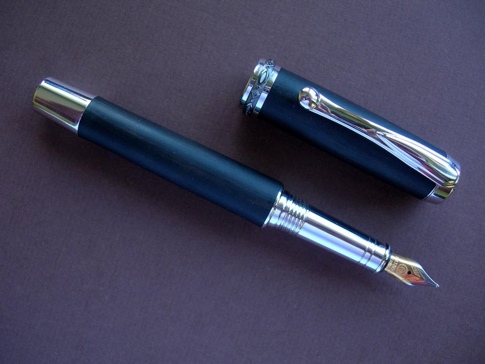

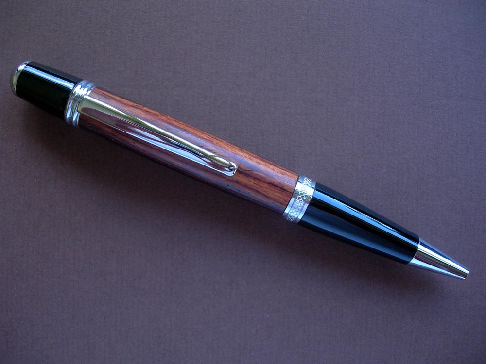

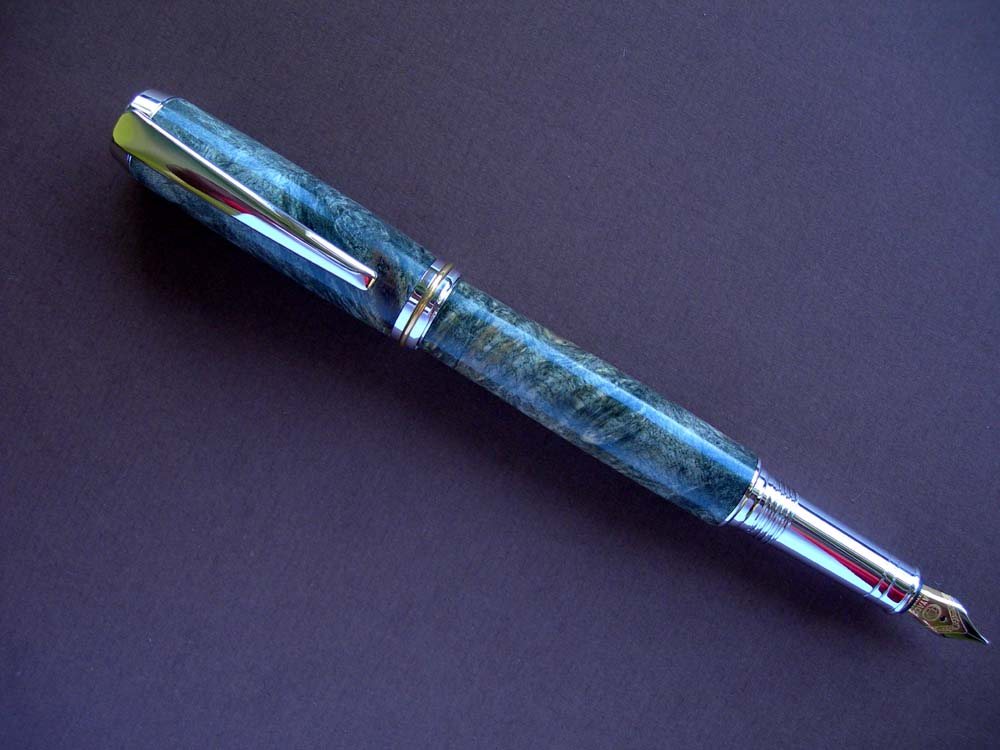

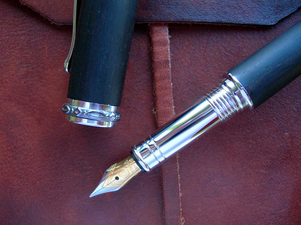

Been busy this week making my first pens. few frusrations but the the wealth of help here was a big help. and, a yard of beech dowel to practice on ha ha. didnt realise i would have to become a photographer as well as a turner! i have just started designing a web site, now i am really getting a head ache.
Hi, Darren. Your pens and photographs are top notch. Do you mind giving us some more information about each of them? For instance, would you tell us about the kits, platings, blank materials and finishes? Some of us are rather new to this business and we can't figure out the details just by looking at the pictures. Thanks.

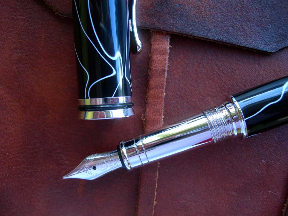

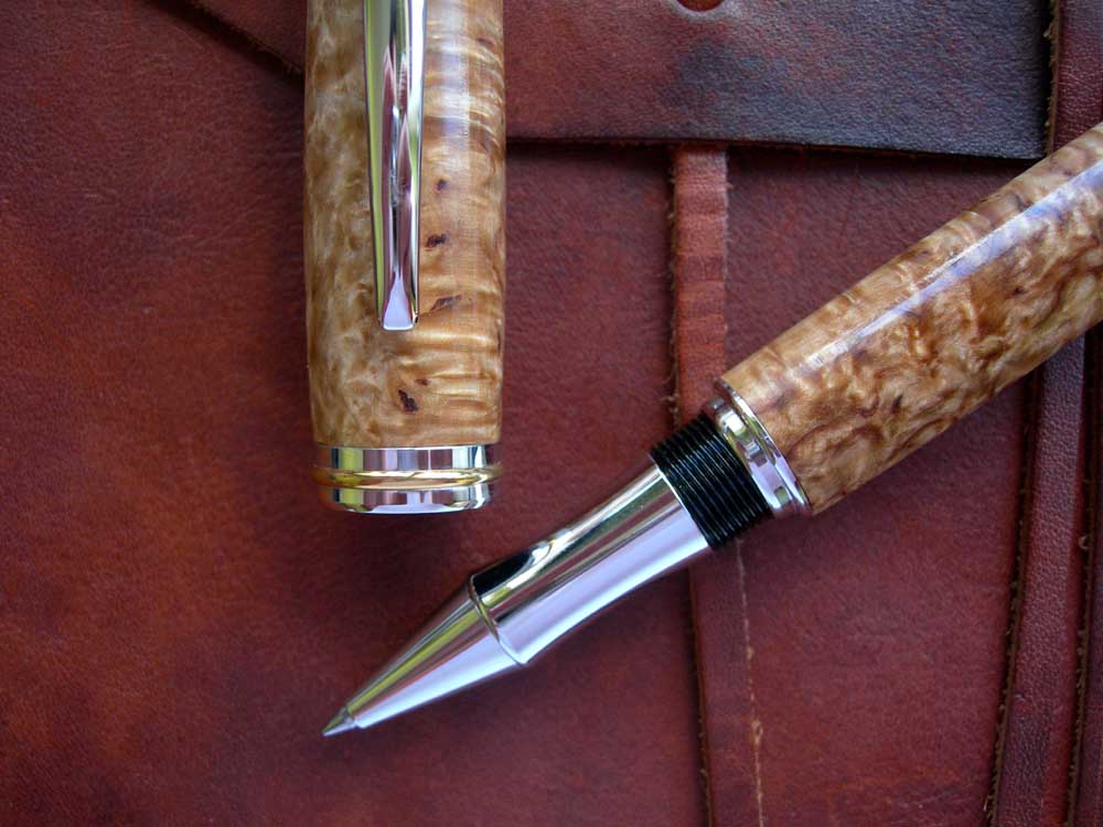

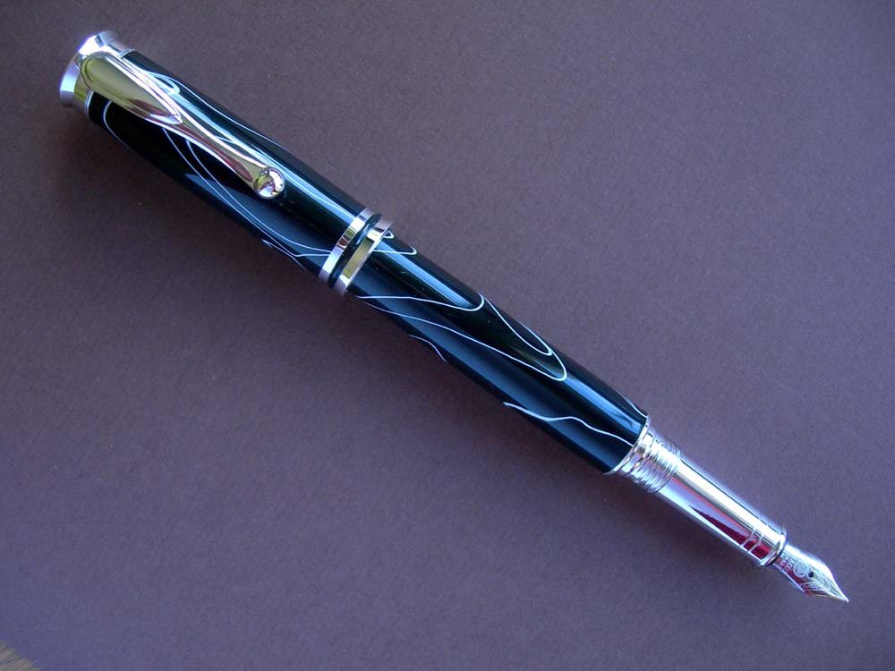

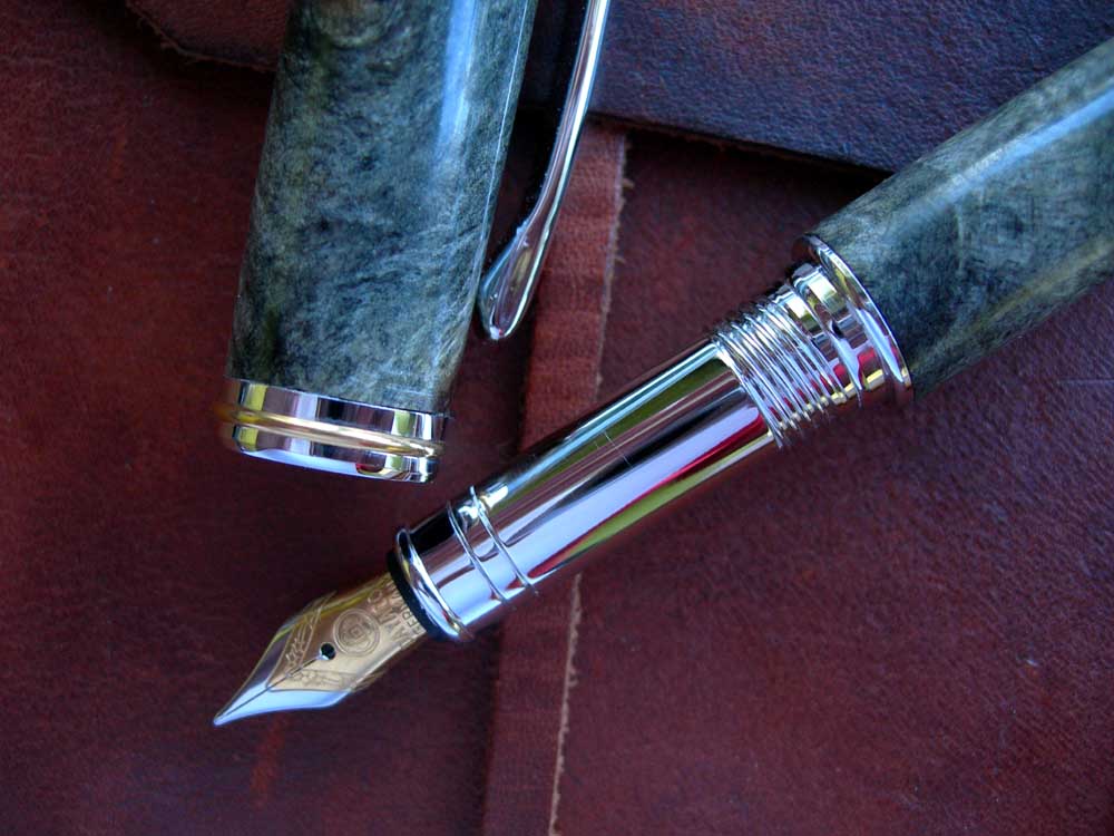

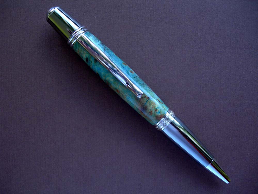

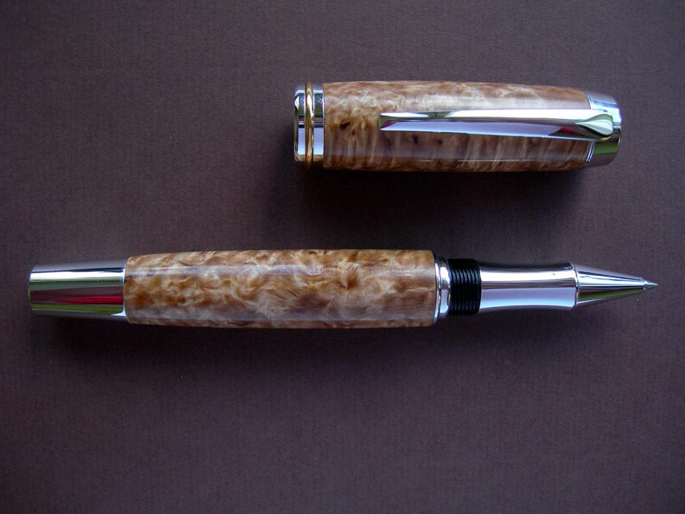

all kits from csusa exept seirra's which i got locally from drechseln und mehr germany. all rohdium unless otherwise stated.
csusa kits are top statesman jr with ebony wax finish, lumber jack? its all i could get from the local diy.
Seirra Titanium, rainbow buckeye, ca and olive oil finish (its all i had)! from csusa
seirra black and crome, cocbola, wax finish, local supplier
csusa retro with thier black and white acrylic
csusa gentleman and thier masur birch, ca and olive oil
csusa gentleman jr and their buckeye burl, ca and olive oil
sanding down to 12000 with micromesh. After initial cleaning up of tool marks using the lathe finished sanding by hand with the grain only. ca, 3 coats of thick
think thats all
