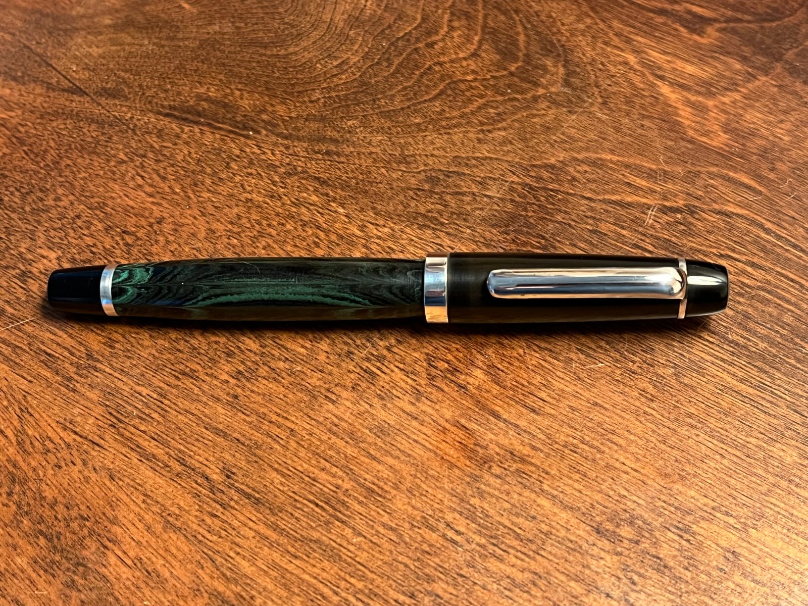

I posted these pictures in my welcome thread, but then I saw this forum. I figure I am more likely to get feedback here.

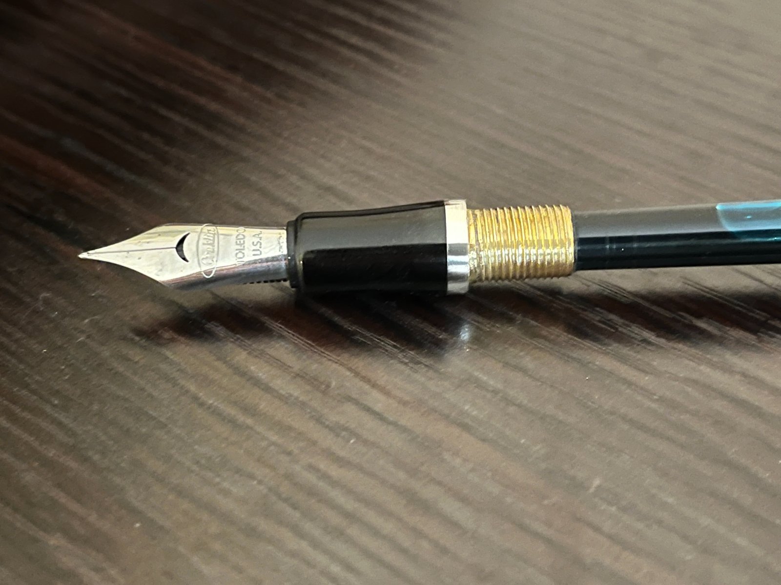

This is the first pen I have made. It is made from ebonite and silver. It was also my first endeavor in making things out of silver. I made a small brass insert for the section because I wanted to use a threaded converter and I also wanted to limit the pen's diameter to 14mm. Trying to do both caused the wall of the threaded portion of the section to be too thin, so I made the brass insert because it can handle having a wall thickness < 0.5mm. The section to barrel thread is M9x0.75 and the cap thread is M12x0.75. I'd love to have a triple start tap/die for the cap, but I don't plan on selling these, so I really can't justify spending the money on that.

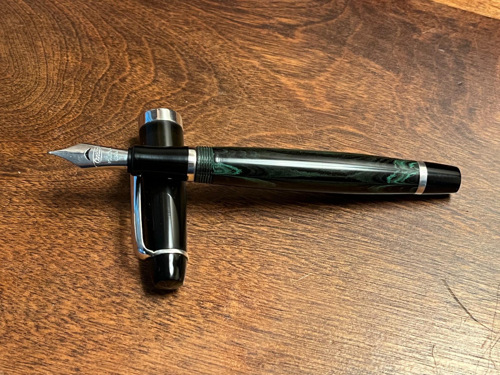

I think I am going to remake the cap because in bright light the middle of it is slightly brown. I'm not sure if it was just a bad section in the ebonite or if I got it too hot while turning, but none of the other black parts had that happen. I tried sanding it down a bit, but it appears to be brown all the way through. I also didn't follow my original plan of making the ring for the clip first, turning the cap to be flush with the ring, and then soldering the clip portion onto the ring last. I was impatient and too excited to try out my clip idea that I completely assembled the clip before turning the cap. Then when I turned the cap, the clip ring ended up being slightly proud of the cap surface. I would prefer everything be smooth as you run your fingers down it. Another thing I would do differently are the threads on the barrel. I made the barrel flush with them because I think it looks really good, but after adding the cap, I think having a very slight step at the base of the threads would make it look better when capped.

Excellent!
My preference is for the threads to transition into the barrel with no step (just as you have done here), probably I had a pen with a sharp step sometime in the past and it's stuck in my head.
Black ebonite does go brown when it oxidizes, you might be able to restore it with some hand polishing with a mild abrasive (such as toothpaste) or a reducing agent (maybe lemon juice - it works on apples!)
Do you have any prior experience of metal work, or was this whole thing a new adventure for you?
Great job either way!
This is a very strange post. The first pen you ever made was a kitless green ebonite body with Argentium silver bands and a brass sleeve. I think there is a backstory missing. Nice pen.

That is exactly why I did the threads this way. Maybe I don't need to make a ledge, maybe I just need to make the cap a little narrower. I wasn't sure how thin I could make the walls of the cap, but since it has a silver ring around the bottom, I can probably go thinner.
I already tried sanding down the cap and polishing it again. I think I overheated it while drilling it out and caused it to oxidize all the way through. I'll just make another one.
No real metalworking experience, I have plenty of electronics soldering experience with a soldering iron and I have sweat/soldered a few copper pipes in the past, so I know the basics of how soldering works. The first ring for the pen I fused (because I was too cheap to buy silver solder), but then I quickly realized that I just got lucky with that one because the next several I melted. So then I bought the silver solder and it was much easier. The fusing would probably work better if I had a jewelers torch and not a propane torch for plumbing that I had laying around.

Here is the brass insert I made for the section. It is M9x0.75 on both ends to screw into the section and the barrel. On the inside it is threaded differently on each end, one end for the converter and the other for the nib housing.

Thanks, I might try that sometime. This time however, I'm pretty certain it is oxidized all the way through caused by heat when I drilled it out. I sanded it down and polished it again and the brown still remains. Also, it is only brown in a very well defined band in the center of the cap. I drilled out 3 different diameters and there is no brown where I drilled the largest and the smallest diameter. Only in the middle where I drilled out at 10mm. So I think when I drilled out the 10mm diameter I let it get too hot.
You bring up a good point though, I knew UV, heat and water caused ebonite to oxidize, but I didn't even think about that and wet sanded it. That was probably a poor idea.
If you can find those 3 trashed sections, maybe use them to experiment to see how thin the ebonite can be turned without breaking up. Metal, as you say, is much stronger.
That is exactly why the sections are in the trash... I was trying to make the end threaded M9x0.75 on the outside to thread to the barrel and M7.5x0.75 on the inside to thread the converter into. I found that ebonite cannot go that thin. The silver band is only a little under 0.5mm thick and is placed over a tenon cut in the ebonite. But I bet even that little bit of silver is enough to let me make that ebonite tenon really thin. It probably needs to be just barely thicker than the threads (which of course would have to be drilled and cut AFTER I attach the silver sleeve).

Ebonite does tend to oxidize, even after being polished again.
I usually use a liquid automotive silicone—the kind used for car dashboards—to keep the pieces looking good.
One detail worth mentioning is the combination of silver and ebonite. The problem is that silver darkens quickly when exposed to sulfur—and guess what ebonite is made of?
My suggestion is to have the silver rhodium-plated (or even gold-plated) if you want the pieces to remain shiny. Varnishes don't last very long. If, however, your goal is for the pieces to have a darkened appearance, then the issue is already resolved.
