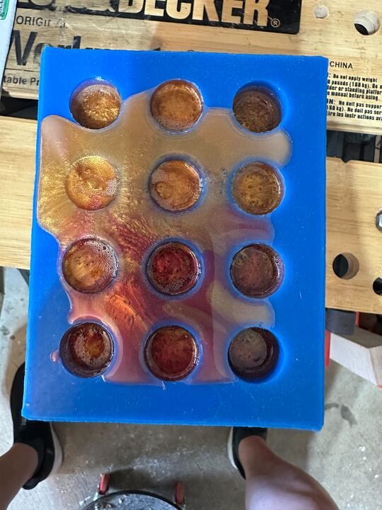

I scored big when I joined this forum on a giveaway of some pressure pots, molds and resin and finally got around to trying a pour. That was a while ago. I'm not sure what the shelf life is on an open Alumilite clear slow. It's been sitting in my unheated garage from 20F to 90F recently. Was 85F tonight when I made my attempt.
The town the gallery I'm at is having a Swords, Broomsticks and Mystical Beasts event and I'm trying to get some blanks together to pair with some dragon, skull, serpent, knights armor and phoenix components I have on order. This pour was Pearl Ex Russet Red and Aztec Gold, 98% single color. I put just a dash of the opposite color in just hoping for some contrasting swirls.
I only had 16oz solo cups so didn't think I could safely pour a single color to fill the 12 blank PTownSubbie mold I wanted to use. So I did 2x250g. I poured pretty early, almost immediately getting the pigment mixed in. That's mostly FUD around my first pour and trying to get into the pressure pot, getting the lid on and pressurized. My aim was pretty terrible on the russet red, puddled on the top of the mold because my aim was off. The gold went a bit better but poured the last bits over both just to fill the molds. I won't need the full 5" for the pens and it might be a happy accident that looks cool.

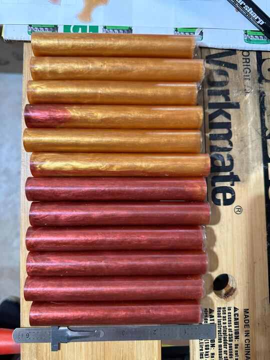

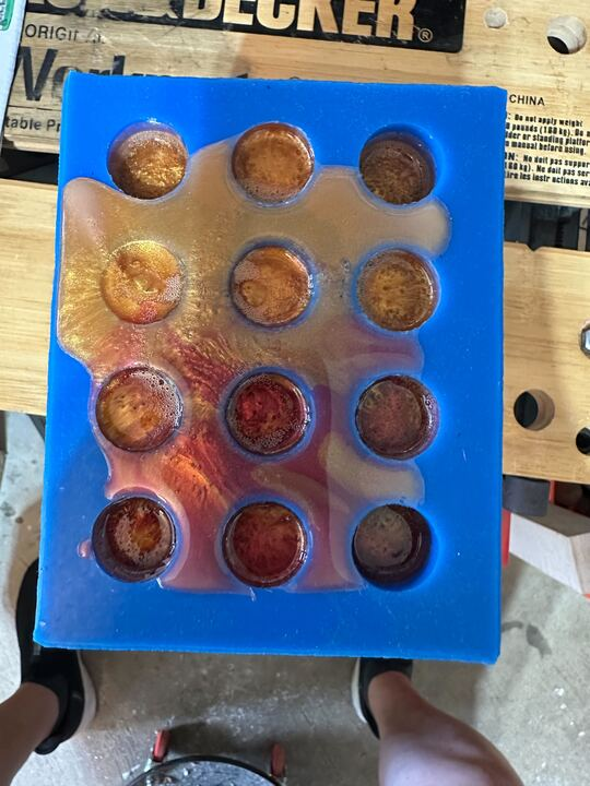

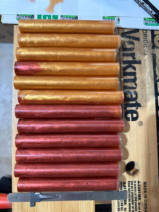

I think they turned out well. I won't turn them for a few days, so we'll see. The first image shows all the over pouring where I missed. I was shooting for mostly solid colors just to see if the resin worked, I think it did.

Wow - for a first pour ever, they look great! If you think your spilling was excessive, I'm embarrassed to show you mine after a good pour...lol. I just have given up to trying to be neat and add an extra 10% or so in my volume calculations to deal with it. I'm more concerned with getting everything into the tube with enough time to do some manipulations of the resin then I am in being neat. Just spray some mold release into your pressure pot to keep if from making a mess of the pot or consider a throw away liner.
Waiting a few days for the resin to fully harden and cure is a must - they remain a little on the soft side for a bit until they are really done. One thing I especially love is watching the blank continually change as it is being turned - the outside of the rod rarely looks exactly like what's hidden inside.

I just ordered some stoner mold release this morning, so even with the air gun nozzle it was tough getting some of those blanks out. That's a good idea about using mold release in the pot itself, I have a secondary insert for leveling but I'll definitely spray in there. I poured with the mold in the insert but had to move the insert to the pot after I finished. I'm working off a workmate table in my unconditioned garage. Some day I really will try to clean and organize it but if the last 15 years are an indication it won't be tomorrow.

I found rectangular oil absorbing mats at West Marine that I use for my mixing spot and for the pot base - on top of the plywood insert I have in there for a level bottom (which has a bubble level cut into the middle). They work great and I toss them when they get too messy. Auto stores usually care them too. Keeps my workbench and casting area a bit less colorful...lol.
I try and always let my fresh castings sit for 2-3 days to cure. Since I do pretty much only custom pens, one of my first steps is drilling and cutting for the tenon threads, so I like the blank to be really hardened before I start, so I wait, but that is just me.

I've been told to give them about a week if you want the best polish on them

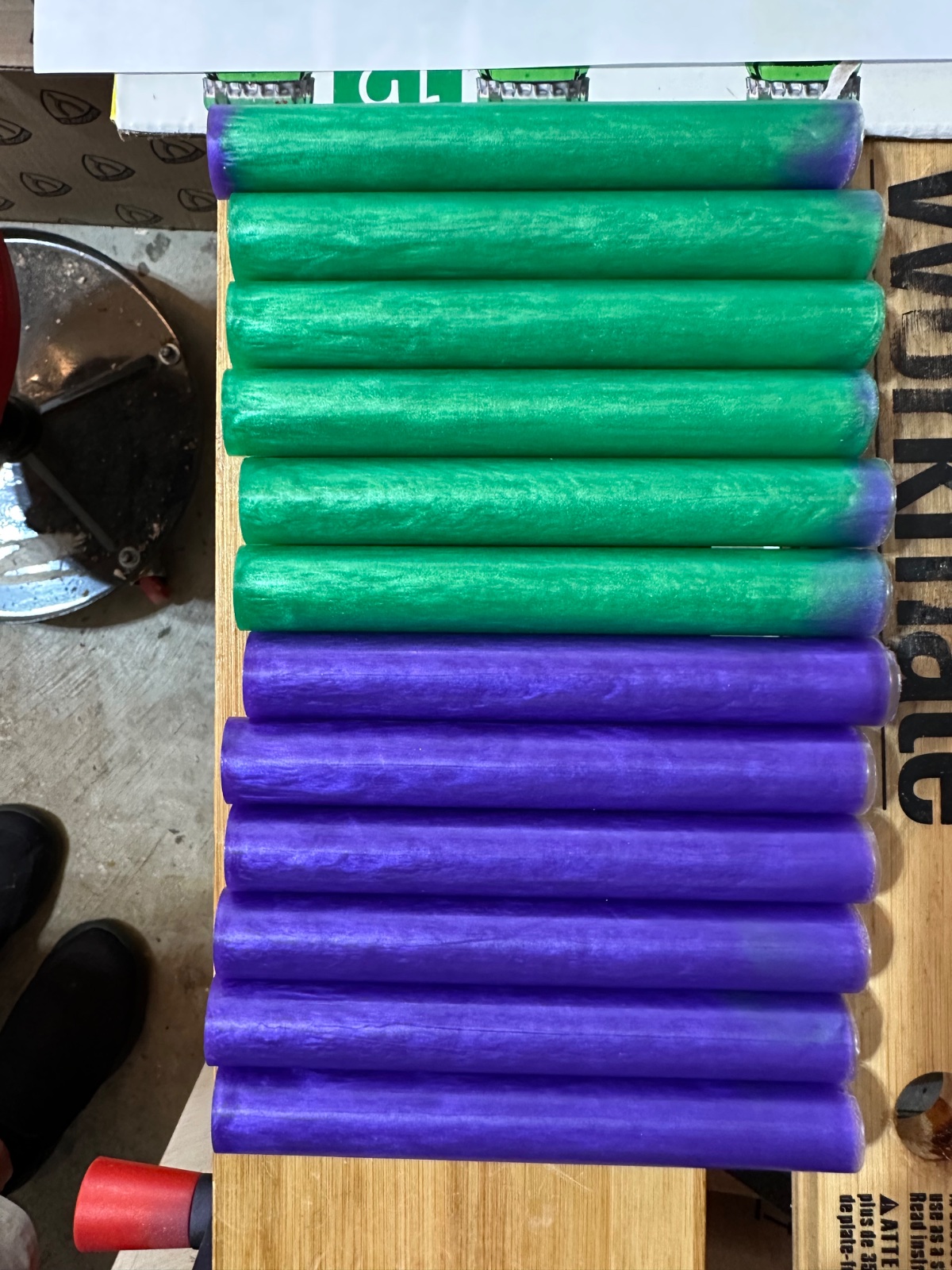

Last nights batch, reflex purple and emerald green. I need a better pouring solution for part A. When I get close to my target I slow down and ends up dribbling down the outside of the jug and making a mess. Was 3-4g over on the A for the green.
