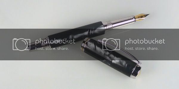

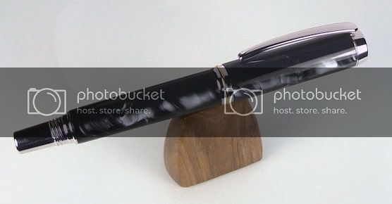

I'd forgotten how good a fountain pen writes! I hadn't used one in probably 30 years. My first one is this Jr. Gent II Rhodium in an Antique Pewter Lucite blank from Exotics. The tubes and inside of the blanks were spray painted black and it's finished through 12,000 mm and One-Step. Can't wait to show this one to some friends at work.
This is also my first attempt at using HDR on photographs.
