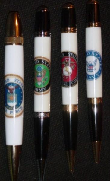

An atlas and three Navigator 2 pens. They were easier than I thought to do and really came out great on white corian.
Yes I did my own decals
I used testors decal paper and then i sprayed 3 coats of clear acrylic to lock the print to the decal paper and then I embeded the decal in CA (many coats) and then wet sanded to 12000 so you can't feel the decal and then polish.
