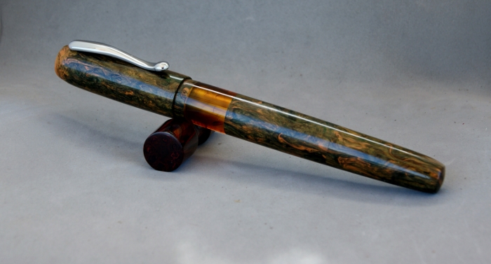

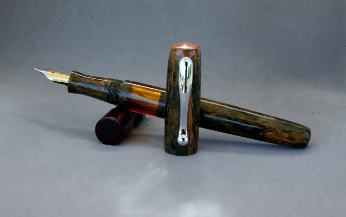

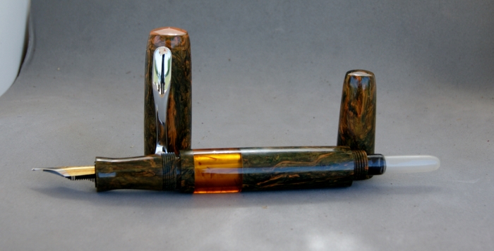

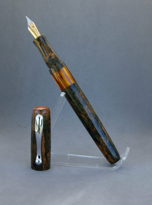

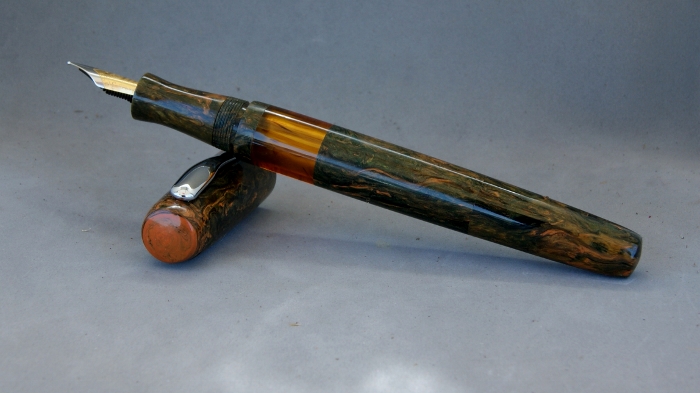

Here's my very first bulb filler. I had a hell of a time getting the ink system to work properly, but after talking with Richard Greenwald at the MAPG he really helped me get on track. The ink window is Lucite (ancient amber I believe) and I cast the rest of it myself in alumilite. I wanted to try my hand at really tuning a nib so I used a one off a kit. It was misaligned and very scratchy to start with. After some work I got it aligned and now it's silky smooth with a nice wet flow. Here are the specs:
Dimensions:
Capped: 6 3/8"
Body: 6 1/4"
Cap: 2 1/4"
Threads:
Cap/Body: 14x.75mm Single start
Section/Body: 10x1mm
Ink System:
Bulb Filler
Thanks for looking! Comments/questions are always welcome.
