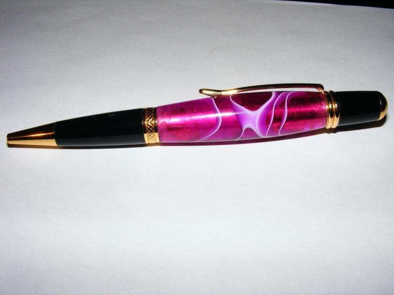

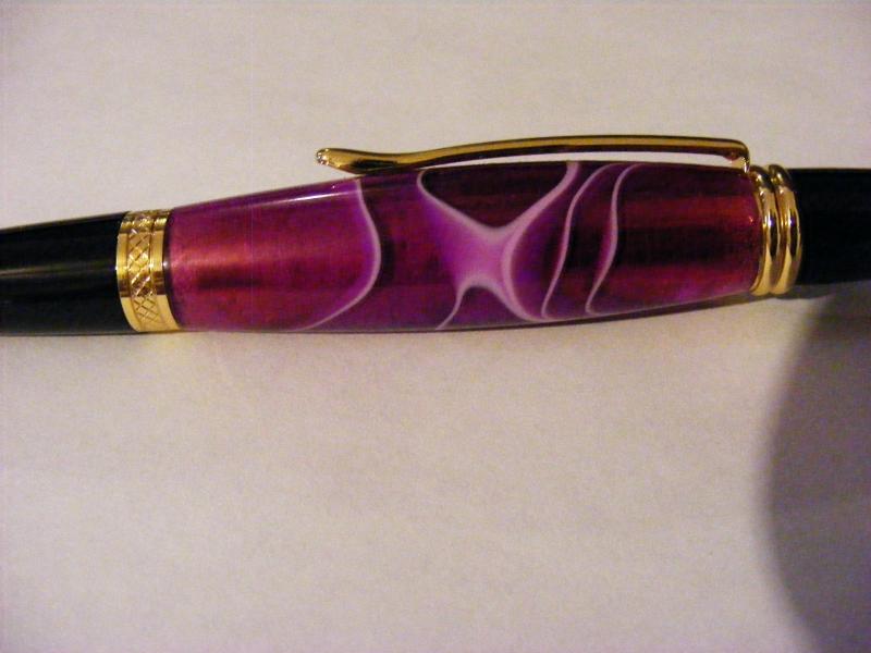

This is my first acrylic. Just one thing i dont like about it. How do you keep from seing the glue on the tube. Is there a trick i need to know about? Any hints would help. The finish is smooth as glass but seing the glue makes it look rough in the picks. Thanks

It's usual to paint the inside of the blank, and/or the tube prior to gluing the tubes in. Painting the 'hole' in the blank is best as it will cover any glue issues and hide the tube
Nice job. Love the color
Painting the inside of the blanks (called reverse painting) works best because that blocks the view of the glue. Painting the tubes as well helps in case the paint is thin and the glue dissolves some of it.
Aww man, I've turned that blank a couple of times, and for your first acrylic, and you definitely have to do some painting on it. If you search the forums for reverse painting blanks, you will find all the info you will ever need. Took me a couple different technics to find the one that worked for me, but learned it here. Good luck and happy turning.
Dave
Thanks for the info. I actually thought about painting the tube but i had already glued it. I did'nt think about painting the blank though. I still have half that blank for the next one and will def. paint it.
