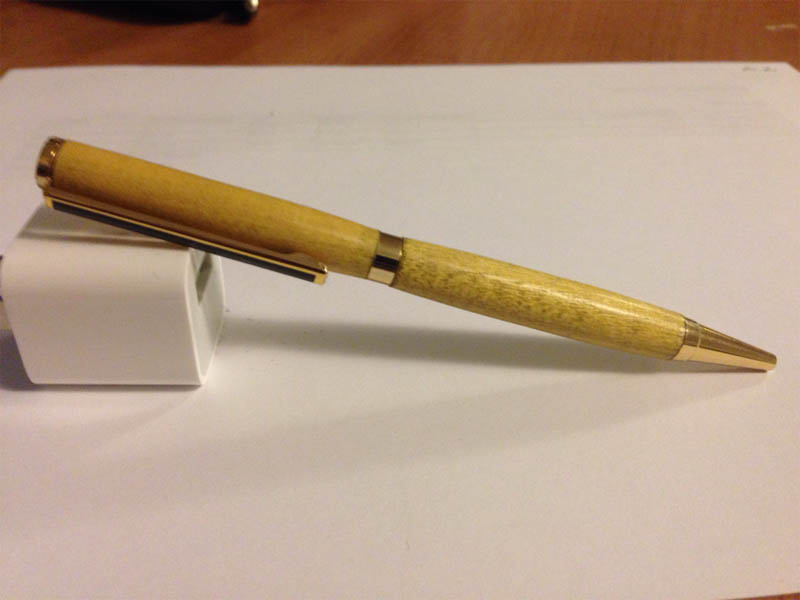

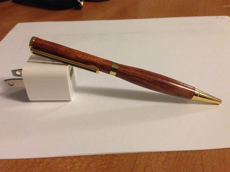

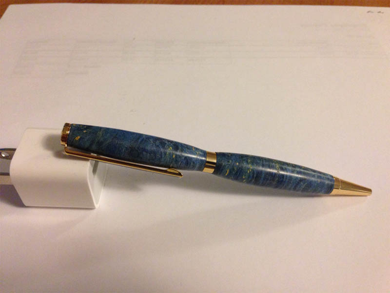

Here's my first 3 attempts at turning some pens. I can definitely say I am hooked! haha I absolutely need to work on finishing them better. It seems the CA finish has a bit of a learning curve to it.
1st
Babinga on a slimline kit finished with CA. Need to work on that for sure. There's some parts at the nib that are a disaster.
2nd
Pau Amarello on a slimline kit finished with the Beall finish system (white diamond and carnauba wax)
3rd
Unknown dyed stabilized on a slimline finished with the Beall system.

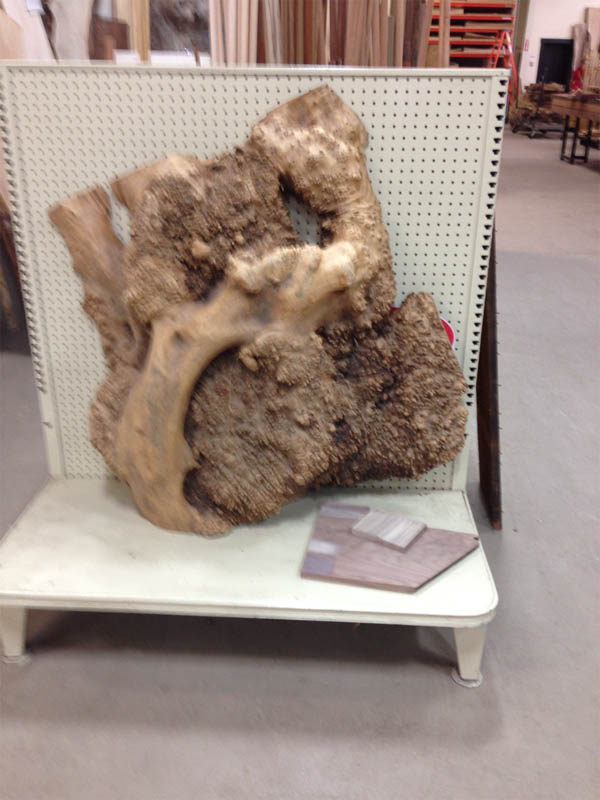

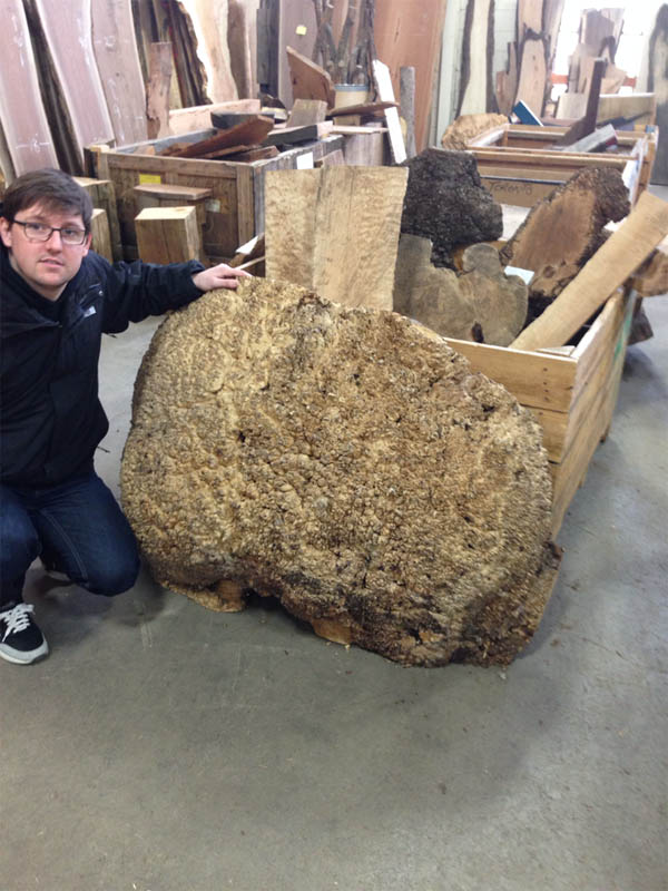

I have the fortune of having a family member who works for a wood store who has some great pieces of wood. I attached a couple photos from there today as well.

LOOKS GREAT. My first pens were recycled in the dumpster. Just remember, this is not a race, learn technique and get comfortable. When I first started I turned 3 to 5 pens a day morning, noon, and night..... they all looked ok but not great. Today I take much pride in turning a $2 trim line kit using a pecan branch in the yard, dying it, adding a decal, staining it, but making it fit and finishing it to the best of my ability..... my 2 pennies worth.

Well, if that family member is not your best mate, you may have to work on it and make it be, working on a wood store with all those treasures, I would be hanging to him/her like a Koala bear does to a tree...!:eek::wink::biggrin:
That's just the beginning of a long road, keep them for reference as you get better and better, we all started somewhere, you seem to be doing quite OK...!

Welcome Mark from Sydney Australia,
Congratulations on your first 3 Pens.
Turning Pens is not as difficult as we would like people to think.
The skill does come in after you have turned.
In Finishing, try to get your blank as smooth as you can off the Tool, then work your way right up the Grits, use clean dust free abrasive, keep it moving, don't hold it still in one place.
Wipe the blank between grit changes, if any blemishes develop with using a grit, then go to the lower one and redo the blank, also lightly sand the blank lengthways when finishing the grit.
Inspect closely before moving up a grit.
You cannot get a great smooth finish on a railway track, it has to be blemish free, before you start to apply your finish.
