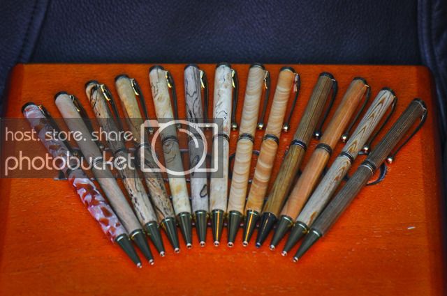

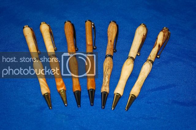

...makes me realize how talented ya'll are.
After making 25 pens, you would think I'd have this all figured out and a nice system going. I'm better at some things but still figuring out some other things. So far, they've been decent pens that have impressed my friends enough to give them as gifts but I'm just not totally comfortable and satisfied.

Nice looking work you've done so far!

Very nice pens. To help reduce the heat build up that 76winger is talking about, you can also reduce your lathe speed, in combination with the reduced pressure that he mentioned.
That's a fine selection of pens! :smile:
