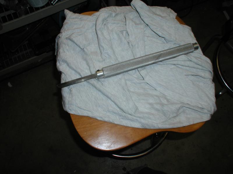

A few posts about tools have been around lately. This is my mostest favorite tool. Home made. Thought I really had something until one time at Woodcraft I saw a tool by some guy named Sorby(:smile:) Oh well, I still like it. So do the kids I turn with at church on Wednesdays. Not the best pic, but it is a 1/2 by 1/4 real HSS rounded off on the end, with a knurled aluminum handle. I think the fact that it is flat makes it easy for the kids to control.
