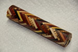

I had this idea a while back and finally got bored enough to do it! I took about 15 different pieces of wood and cut them up into tiny pieces on my bandsaw. Then glued them together to make a very multi-colored herringbone. See, I have been doing something besides harassing Bock for nib prices...
Let's see, I can't even remember what all woods are in here. I know there is maple, african blackwood, ebony, lacewood, purple heart, yellow heart, red heart, cherry, walnut, zebra wood, cocobolo, bocote, some spalted something or other... and a few more.
Anyway, this will become a pen sooner or later!

That's a nice blank. Really nice. How'd you put the pieces together so they go around the tube? All I could manage was a flat herringbone.

There are a few "tutorials" on the forum. I think I just saw a new one over the last few days actually. It's tricky and even when you know how to do it, it's still time consuming...

Thanks. Any suggestions on what to put it on? I mostly use the jr. size pens, but I think a "regular" size pen would show off the blank more with a larger diameter.

Nice Jeremy! I love the herringbones, but me and the short bus usually glue ourselves to the project---literally!
I can't wait to see the finished product! I would vote for a very high quality plating, but less ornate CB and fenial. With a blank this nice, you don't want the hardware competing with the workmanship.

I think, but not 100% certain, that the fs gent comes with black ti. One thing we have done in the past when we really wanted to show off a pattern in a piece is to "thin down" the center band. It does mean you have to adjust for doing so - but worth the efforts.

Thank you. And thanks for the advice in slimming down the center band. I may try that. I thought about doing a closed end, but with the herringbone blanks, there is a gap in the center of every other layer... unless there's another way to glue it up that I don't know about.

Sorry to hear about your mother,the blank is beautiful, CSUSA lists a Titanium but I believe its a gold TI. perhaps the Rhodium would look nice, also a durable finish.
