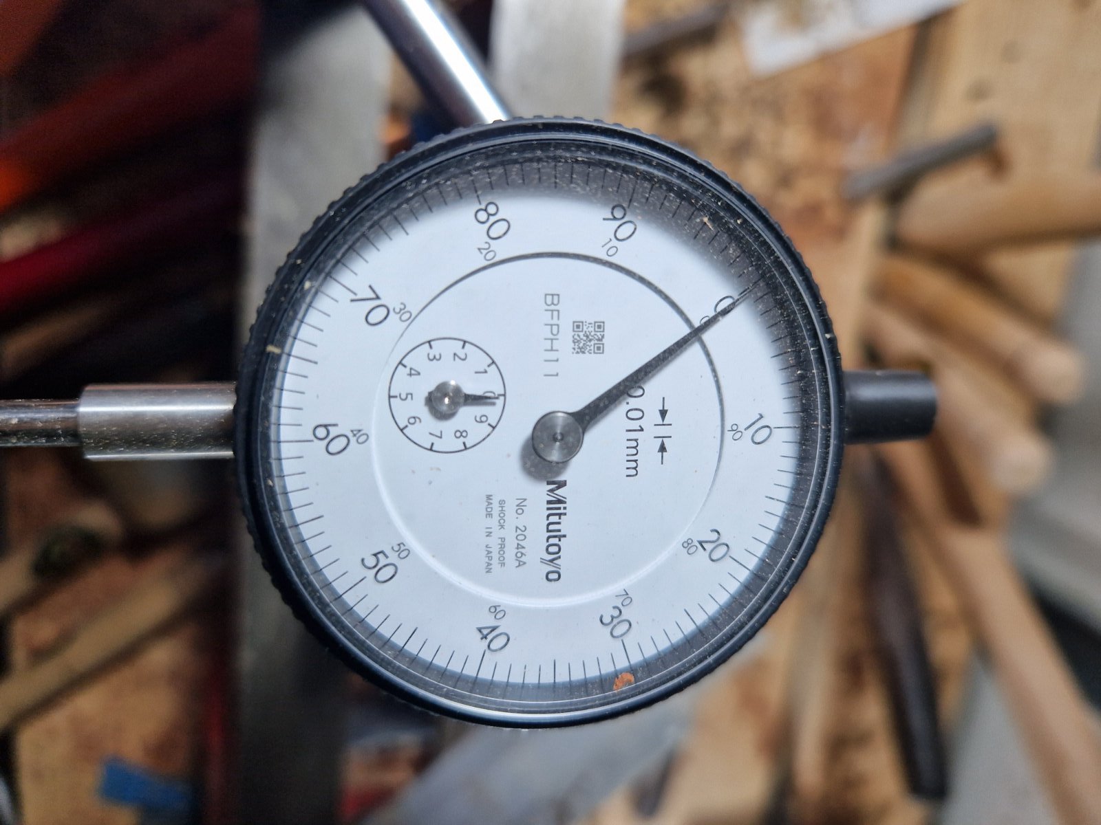

Sorry for the delay but it was impossible to find shop time sooner. So i watched @rherrell video a dozen times and did everything by the book. I think that it might be a headstock thing after all, the collet chuck seems to have a similar accuracy with the pen chuck. Thank you all for any advice, cheers.
P.S. i also include a picture of the dial

How is the collet chuck attached? If it is using the taper, there may be debris inside the taper. That taper must be very clean. Check for any galling, raised divots on the matting faces of the two tapers. If it threads on, the face of the nose may have debris. Debris can be anything from over spray finish to saw dust.
There is a specific "load" order to the collet chuck Snap the collet into the nut, the groove in the collet should snap into the ring inside the nut. The collet and nut thread onto the chuck nut. Then put the rod into the chuck and tighten.
Hope this helps.

I found that when I use the plastic rings to help keep your chuck from binding on the headstock I get a fair amount of runout. I think it is because the milled surface of the headstock and the chuck have to mate through the plastic ring and they are anything but dead flat. I stopped using the anti-bind rings and got rid of my runout issue. Have to occassionally work hard to get the chuck off, but......lol

Yes it is threaded on the taper which is rather clean i dont think thats an issue

No i dont use a washer of any kind just the chuck

I had this issue as well, getting the chuck off - and one day read the manual fully and it recommended anti sieze compound. It's kinda messy to work with but seems to be helping.
I have two very skinny Teflon rings that I use on the headstock spindle. Never had a problem with the chuck sticking. Got some extra jaws and the washers are much thicker. I don't use them.
