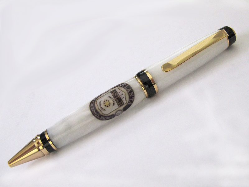

This is the pen I made for our motorcyle group to giveaway at our Christmas party. Turned out pretty good. Logo is a decal. Pen is a cigar with white pearl acrylic. Decal is covered with CA and polished to 12000 with MM and then HUT Ultra Shine. I also did CA on the top to keep the finish consistent. Overall I am happy with it. The decal is a little more translucent than I would like in the black areas. I need to work on that aspect. Comments and criticisms welcome. This is pen #14 so I still have a lot to learn and your critiques will help.

I really like that pen! Nice job. Whoever ends up with it will love it.
I like the choice of colors and finish for the kit. This will make a great giveaway
