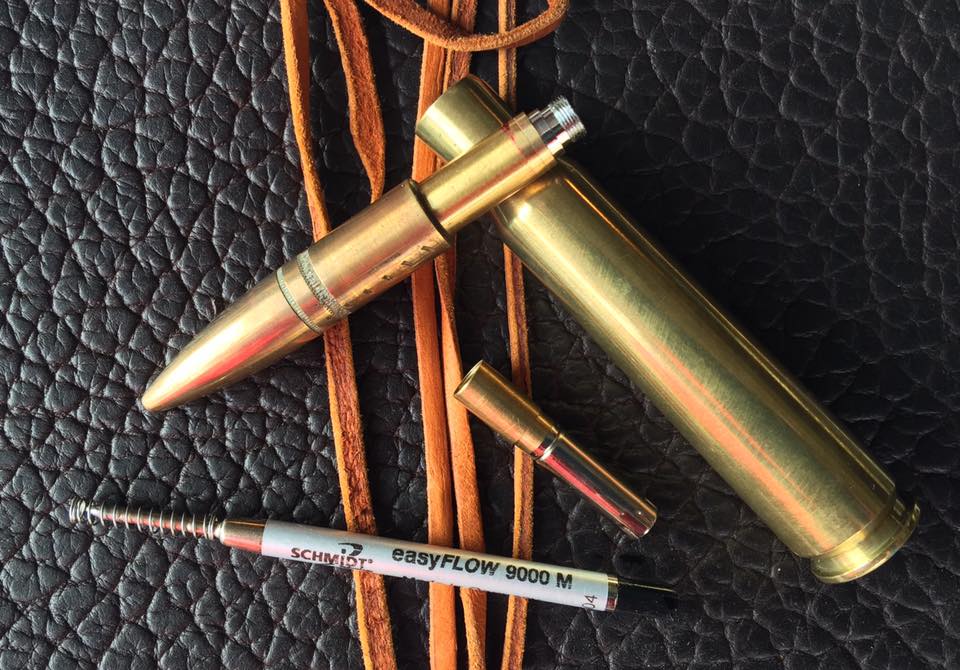

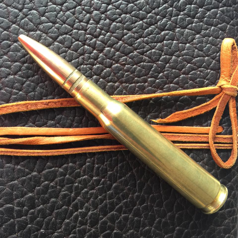

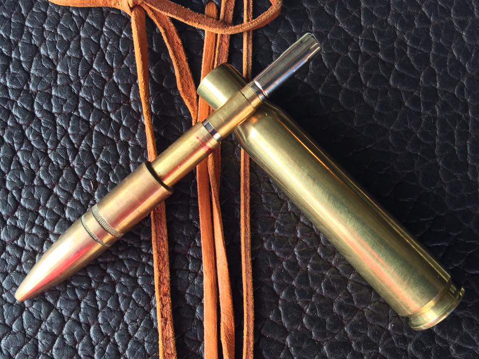

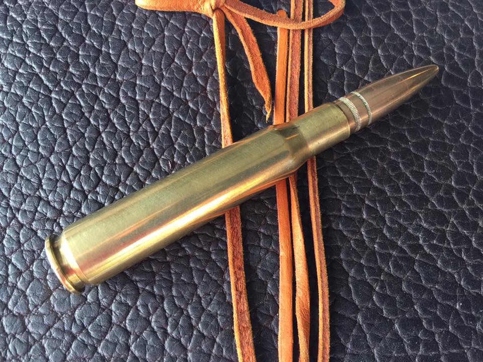

Here is my take on the BMG .50 Cal Pen. Loosely following instructions in the library, but I made a few adjustments to suit my needs. As you can see my BMG .50 Cal Pen uses the Parker ink refill.
Rather than glue the tube into the tracer round, I used a Letter "W" drill bit to drill in to the back of the round. This allowed me to press fit with my arbor press the 10mm brass tube in to the bullet. I then trimmed the brass tube to the length needed for the cigar pen parts.
This was a fun project to make, and I have been wanting to do this for quite some time.
