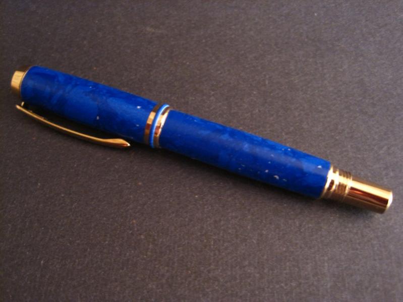

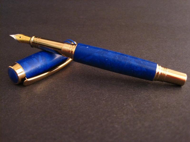

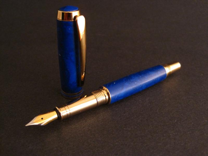

I don't post many of my pens because they are really nothing new, but I thought this one was worthy.
Blue Lapis Tru-Stone
1st fountain pen
1st custom final
1st custom centerband
I didn't use the bushings, just digital calipers, and this is my best fit yet! You can close your eyes and not be able to find the seam. I'm sold on not using the bushings for size!
Sorry about the so-so pictures. Comments and critique's welcome!

My lapis true stone pens look a lot darker than yours. I do love that lighter color.
Tell me, what is your finishing process? Sanding to 600 grit? Micro mesh pads? Polish?
I'm looking forward to trying out some of the Tru-Stones. Your Lapis is a beautiful color. Very nice pen.
NICE WORK!! The tru stones are a blast and look amazing! You did it justice for sure!

I think the photos make it appear slightly lighter, but I still wouldn't call it dark. All I did was turn down to size with my Woodchuck and then wet sand with MM starting at 1500 and going all the way up to 12,000.

Zach, it looks like you have a Chilean Lapis blank which is a little lighter than the Dark Blue Lapis w/ Pyrite. The Chilean Lapis has the little white specs in it as well, instead of the pyrite. It's a great looking pen either way. Nice work on the pen and the customizations!

Great job there! I agree with you that the finial and centerband really make the pen stand out, and try to do that to all the gent's I do. It adds a good bit of time to the assembly, but IMHO it makes a $12 kit stand right up there with a $30 to $50 statesman or Emperor. Put a upgraded nib on that and you have a true custom pen that outshines it's unmodified brethren by a wide margin.
