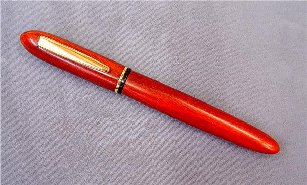

With this pen, I have finally reached a goal that I have had for several years - to make a functional fountain pen with a classic appearance, that shows as much wood as possible, and looks nothing like a kit pen. It started life as an El Grande kit. The result is a large pen that weighs 28-grams with a full reservoir of ink. The cap threads are smooth, and the kit nib is an excellent writer.
Its only problem might be that the cap will not post. However, it has good balance and writes well without the cap.
The wood is Blood, and the finish is shellac over CA glue.

Very nice pen Russ. Can I ask one question. What motived you to add the brass and blank band. IMHO I think they clash, as a center band and would have gone with just the black.

Dan, I respectfully disagree with this statement. Had Russ left the CB just black, he'd still have the gold clip, which would have then clashed w/the black CB. By leaving a bit of gold at the CB w/the black, it allows the clip to do it's job and not look grossly out of place. JMO[;)]

I tried them all. The kit band was too wide. Plain black looked out of place and made the large clip look even larger. Trimming the kit centerband down was just enough to balance the clip.
The cap threads are inside of the black plastic, and I have yet to figure out how to eliminate it.
I will make all three styles because there will always be a difference in opinion of what looks best.

That is great work. I like the styling of the pen. You said the threads are smooth. Did you use the couplers from El-grande or did you cut your own threads?

Thanks, Bill for coming up with and sharing the J-clip idea. I was still hung up on tabs until I looked one day at an ElGrande kit and saw the light. After that, it was easy.
There were a couple questions about, why shellac over the CA finish. My answer us that I am using the shellac (Fristion Polish) the same as most folks would use a wax. It is a protective coating against handling until the pen reaches its final user. The difference is that it doesn't need to be renewed after every show. It makes a very graceful transition to the CA finish as it wears away.
