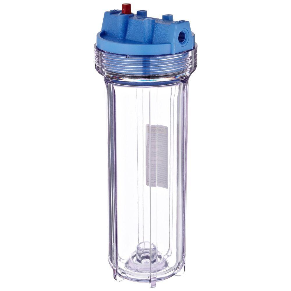

A big Amen on testing with water! And good advice on a dedicated regulator, I'll also add an air drier too. I was really concerned after reading bad reviews of the company that sells the pot through Walmart. So far so good.
I plan on making a drier using one of these and descant beads from Amazon.
I plan on making a drier using on of these and descant beads from Amazon.
Where did you find this? Looks like the oxygen filter I've seen in the hospital.
Its a water filter housing. I bought it for about $13 on ebay but they are much more now. Its rated for something like 80 psi but I would never leave it pressurized.
https://www.ebay.com/sch/i.html?_fr...0.TRC0.A0.H0.TRS1&_nkw=Pentek+158116&_sacat=0
Filled with these. https://www.amazon.com/gp/product/B013L31PQ0/ref=ox_sc_act_title_1?smid=A17QCEXR2SHYMI&psc=1
Just ordered one for $14.58 and good to 125 psi.
https://www.ebay.com/itm/Pentek-158...135983&hash=item41a7f1de62:g:ZlcAAOSwsN9XALaf
Now to order some desiccant. Thanks for the tip.

I'm thinking if you reversed the flow direction the 40 micron filter would keep the silica out of your tools. Not sure why you would filter the inlet of the dryer.
Well my plan is to have sort of a filling station above where I cast, on my table saw.
The air would first come into a small filter water trap to I'm hoping catch most of the water and then into the beads through the outlet, down a 1/2" PCV pipe and out holes drilled in the sides of the pipe. I will probably shove something like a plastic scrubby into the pipe to keep the beads out. The air then goes up the filter through the beads and out the inlet with something shoved in there to keep the beads from shooting out, then into one of those cheap 1/4" plastic coiled hoses into the pot.
I was thinking of cutting thin slits near the bottom the down pipe and flowing down through the desiccant and into the pipe. That way the air flow will force the desiccant beads into the chamber. If done like the video and if the bit of brillo pad comes loose, the beads are headed down the air line. The air direction from the video also puts constant strain on the down tube especially if the filter plugs. It would challenge the glued joint. Pressure and flow from the outside of the tube instead of the inside would push the downtube upward into the cap.
I do like the idea of a water knockout before the desiccant dryer. If I plan to use the dryer for painting I will have to have some kind of filter downstream of the desiccant dryer too. Thanks again for the great ideas.
Danny
