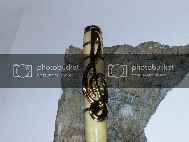

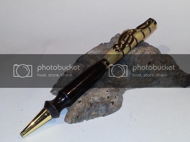

Hey guys, I'm guessing that what I have done has been done often in the past, but so far I haven't seen anybody else do this so I will share it here.
I put the treble clef musical notation clip on a 'staff' background that I burned into an olive piece. The bottom is roasted maple.

Just so my 'slow mind' understands....
The clip end has burnlines not segmenting? And I am not even gonna trying to guess what 'roasted maple' is?
I like the concept and the materials used!! Very cool and not something that is seen everyday!!! Well done!!!
Scott (to clef or to cleft that is the question) B
Yes, the clip end is burnt. I put tiny notches with a parting chisel in, and then I held a piece of wire in the notches as I spun the piece at high speed so that the friction burnt the wood. I thought it would be a nice compliment to the roasted maple on the bottom.
Roasted wood is wood that is heated under pressure - not quite sure how hot or how much pressure, but the effects are most interesting.
