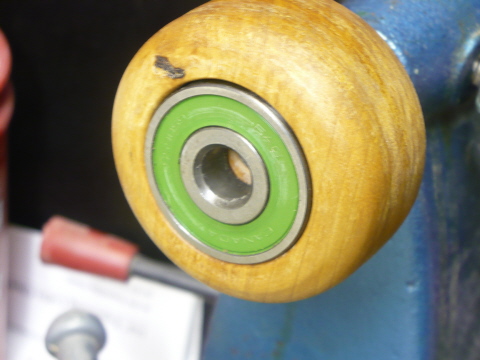

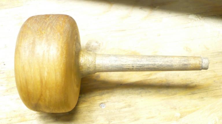

You could make a holder. Here are some images of a bearing holder I made for a MT#1 tailstock. I use this old lathe as a buffer now and I needed to hold a bearing in the tailstock. The holder is two peices of wood glued together. The taper is turned onto the one end.
